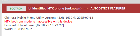

Help do you have DA and AUTH file for samsung A15 5g?
ChimeraTool
Apr 6, 2021
1,952
1,132
Slovakia
asking DA and AUTH in chimera...
model: sm-a156e
original binary is 2
history: after update to bit 5 in SAMFW tool..phone does not power on...it stuck in bootroom mode
Dear User,
To service A156E in bootrom mode using Chimera, you can use the Device Wizard interface to select the SM-A156E model itself from the drop-down list, no need for you to add a DA and Auth file.

phone cannot enter in download mode and cannot enter to recovery mode... it is totally dead now
original FW is A156EDXU2BXE5...I flashed to A156EDXS5BYA1
but it stopped in flashing SUPER.IMG.lz4Flash failed but here the phone is still alive in odin mode state
so I skip AP in flashing, i flashed 3 files BL, CP and CSC..it flashed successfully, but phone never turn on
