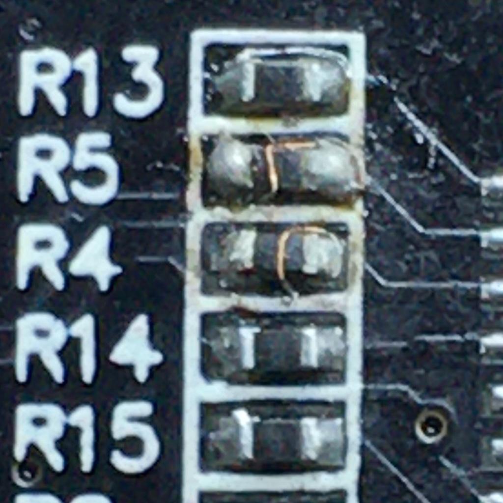

FOR SAME ERROR. BUY MY ONE IS 5 2020 ufs 2.1 chip . and error 113. i try to jump this two resistors. and same error 113. how can i do?

Put only the jumper near the resistor when you get error 113. Don’t remove the resistor. Other model need the resistor to read UFS Chip.
Put jumper only when you get error 113.
Other case you can get error 53 when the jumper is active. So, [emoji91]Put jumper only when you get error 113[emoji91]

Thanks it's working.
