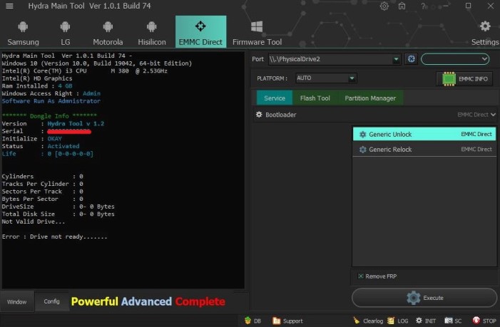

Hello, as many users face "Drive Not Ready" error on Emmc Tab this is the possible solution for the error.

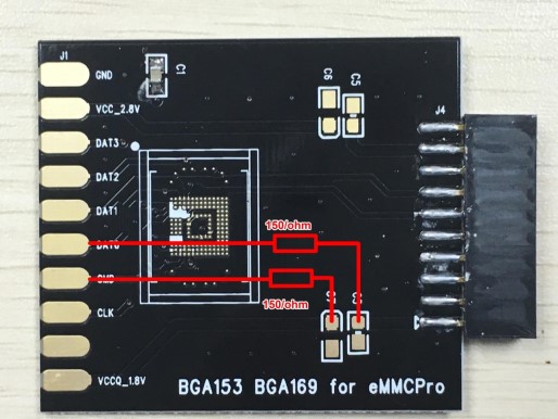

Basically its because of old emmc hardware need modification to be able to connect with Newer emmc chips.
You have to add two pull-up resistors as show in the below image.

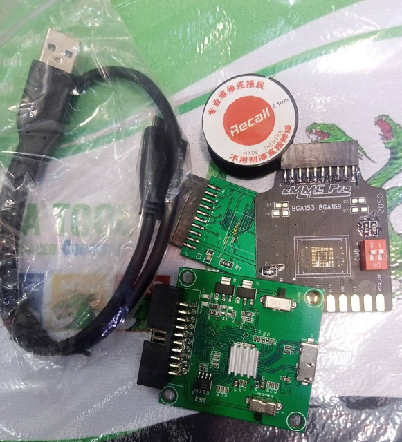

If your Adaptor already has red switch box then its already modified just make sure that switches are towards on side.
