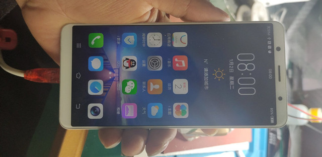

EMT-VIVO X20 (PD1709) Auto recovery mode solve done by flashing

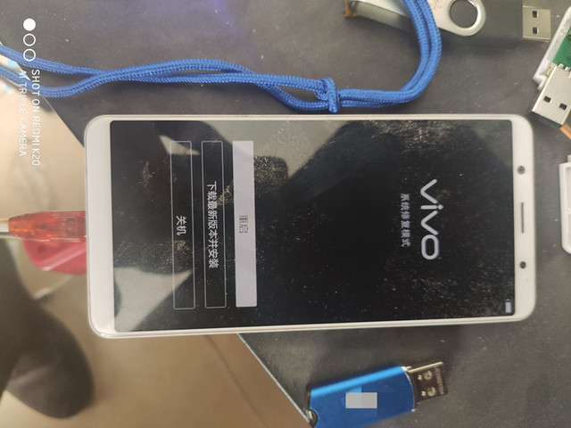

Case: VIVO X20 (PD1709) auto recovery mode
Demand: Flash

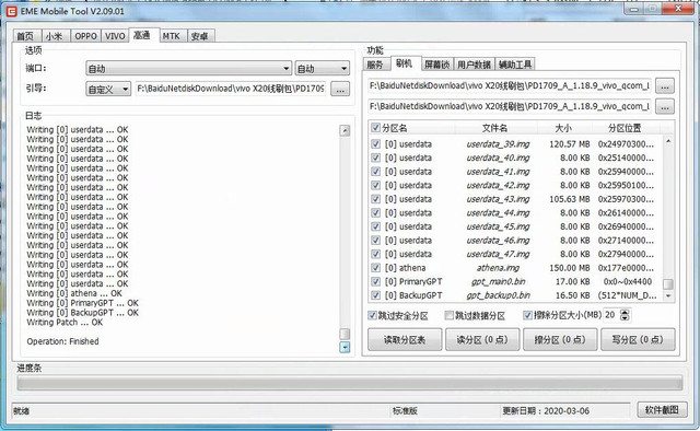

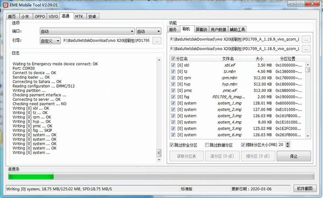

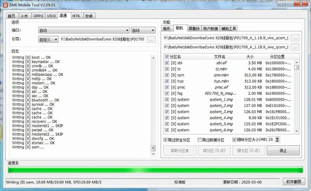

Operation process:
1.Go to Flash Tab, select ROMs
2.Press "Write"
3.Enter Qualcomm EDL/9008 mode connect USB Cable (install drivers)
4.Waiting for the operation to complete
