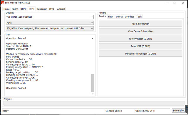

EMT-VIVO Y3 Standard Edition (PD1930CF) Factory Reset + Reset FRP
Case: VIVO Y3 Standard Edition (PD1930CF) Screen lock
Demand: Factory + Reset FRP
Operation process:
1.Go to Service Tab
2.Press "Factory Reset" and "Reset FRP"
3.Enter Qualcomm EDL/9008 mode connect USB Cable (install drivers)
4.Waiting for the operation to complete
Tips: Select Y91 (PD1818F) for this models now, due to this model no in list yet.

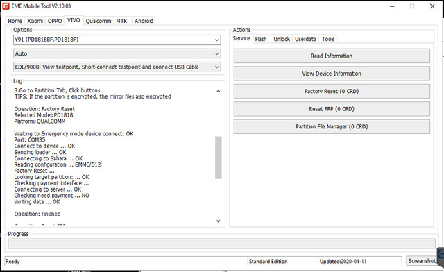

Operation process:
1.Go to Service Tab
