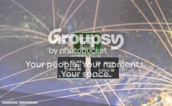

Typically, smartphone and tablets have been using eMMCs (embedded multi-media cards) to store information. And today, we announced the mass production of the industry’s first 128GB embedded memory solution based on Universal Flash Storage (UFS) 2.0 standard.
First, what is eMMC?
eMMC, or embedded multimedia card, is advanced, managed NAND flash memory for mobile applications and still is the dominant go-to memory solution for many consumer electronics, including tablets, smartphones, GPS systems, eReaders, and other mobile computing devices.
(“Managed” here means that it’s a solution consisting not only of NAND flash memory but also controller/interface circuits to help sort out processes and improve performance.)
Samsung eMMC memory is extremely compact, typically smaller than a postage stamp, allowing for smaller and thinner devices. Leading manufacturers have favorited Samsung’s eMMC memory because it allows for a smooth pathway to elegant and advanced mobile designs with a short time to market. The latest standard, eMMC 5.1, even furthered the performance and power efficiency.

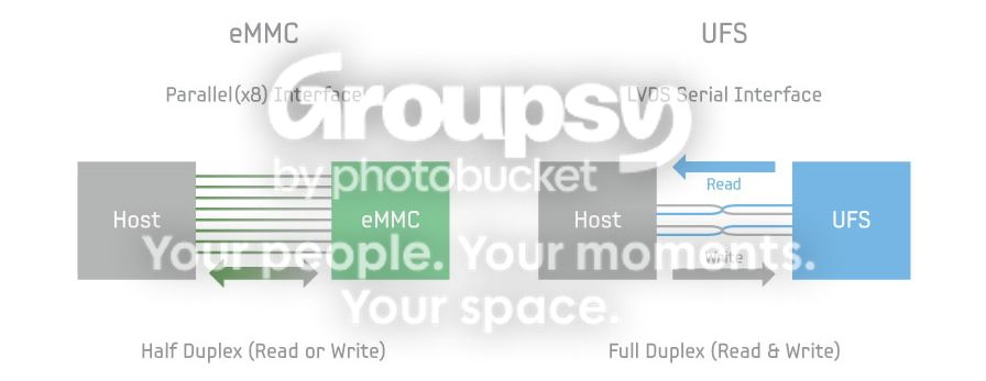

UFS boasts a substantial improvement in performance. There are two main factors that contribute to this.
eMMC-UFS
First, UFS has an LVDS(Low-Voltage Differential Signaling) serial interface which has separately dedicated read/write paths. This allows full duplex(two-way interaction) – in other words, UFS can read and write simultaneously. eMMC, on the other hand, has a parallel interface which can only send data in one direction at a time – it can either read or write, not at the same time.
Second, UFS has a Command Queue(CQ), which sorts out the commands that need to be carried out. Thus, multiple commands can be addressed at the same time and the order of tasks can be changed accordingly. eMMC, without CQ***, needs to wait for a process to be completed before moving on to the next one.
The combination of these two, along with Samsung’s engineering feats allows Samsung’s UFS 2.0 solution has a sequential read speed, sequential write speed, random read speed and random write speed each 1.40, 1.66, 2.71, 1.07 times faster, respectively, than eMMC 5.0.
