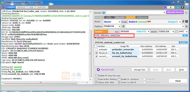

Flash failed, I still lost the credit, please refund the credit to me

Good, look in the log of the operation, the da file is not correct and also keep in mind miui 11 is new security, click on the da section and change the da file.

Connecting Bootrom...
[SERVER] Error: To save flashing slots, your request has been temporary rejected because of previous error.
Please verify your flash settings, you can retry after 23 hours
Platform: MT6765, Hw ver: 0xCA00, Sw ver: 0x0000
Error: -1073348603 (STATUS_BROM_CMD_FAIL)
BROM_SCMD_SLA error. code 0x7046
(boot_rom.cpp, line:1279)
