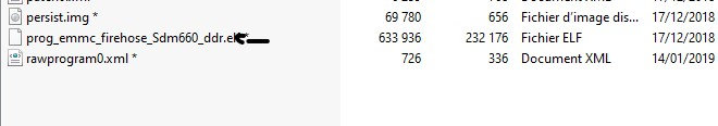

Good, you have the bootloader unlocked, right?
and the persist.img flash in edl mode and get it out of the factory firmware of that model that you have problems

Yes Frank, I have the bootloader unlocked
But I couldn't flash him with any Box because in UMT I don't have credits and I don't know how to do it
