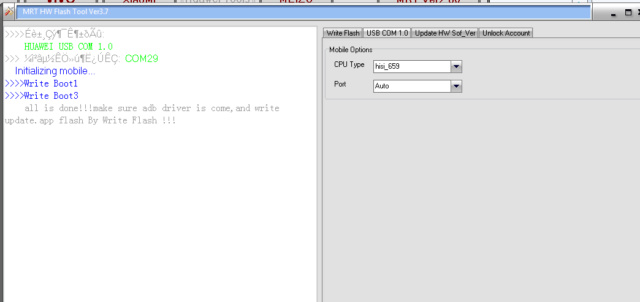

No bypass working , no fast-boot working

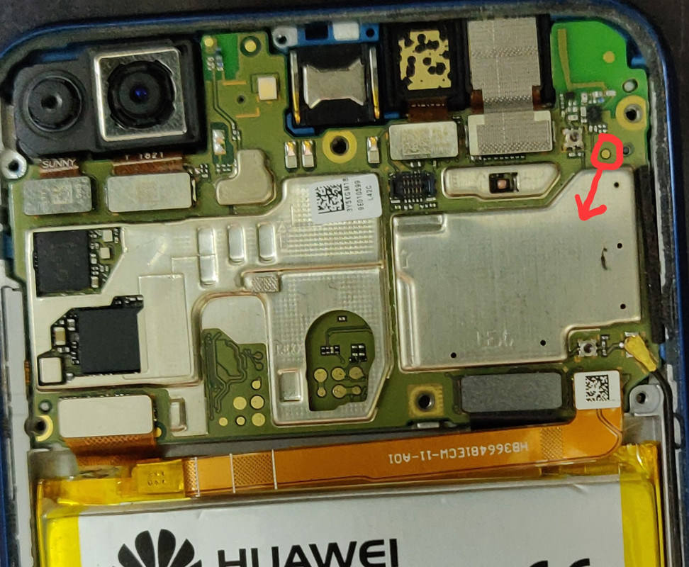

finally test point success
Step 1
connect your mobile test point
if u connect test point ask usb ser driver
open device manager
usb ser driver link :- Huawei-Honor-Driver-2018
install it --->C:\Users\home\Downloads\Compressed\Huawei-Honor-Driver-2018\Huawei-Honor-Driver-2018\Driver\X86\cdc-acm
update on huawei usb modem1.0
step 2 :-

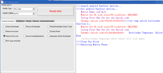

open mrt huawei flash tools
process finish mobile automatically goto fastboot mode
step 3

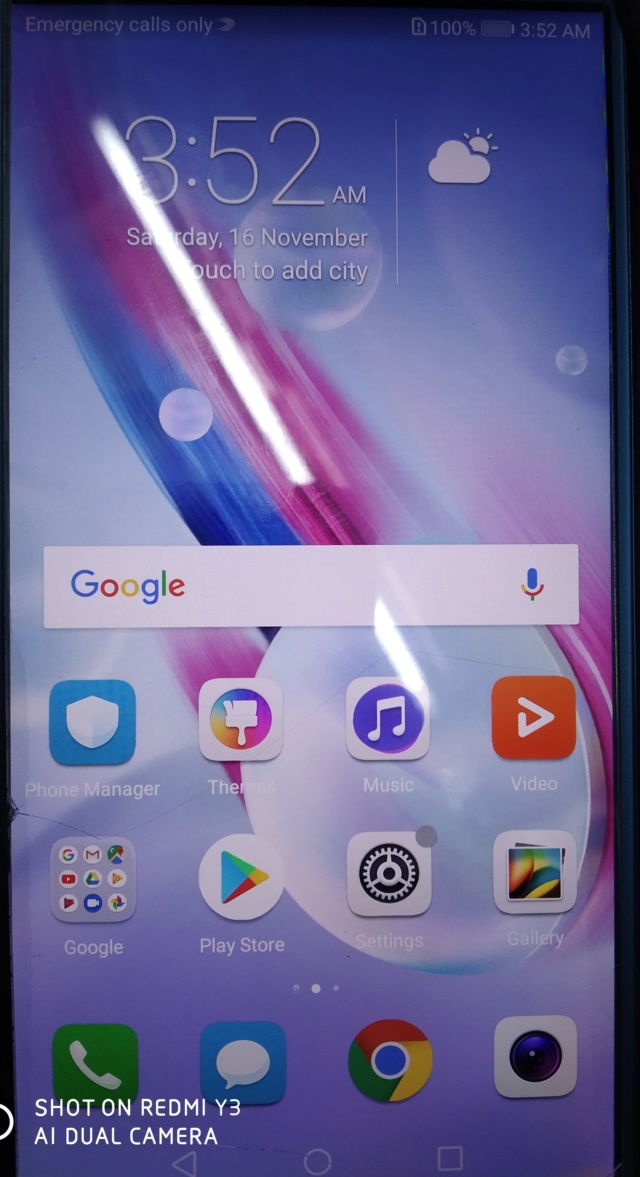

frp done success
enjoy.....................
