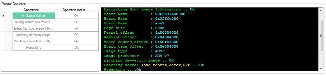

- Creating a root file from the SAMSUNG tab -> ROOT AND KITCHEN CREAT PER-ROOT option
No Risk
Attention

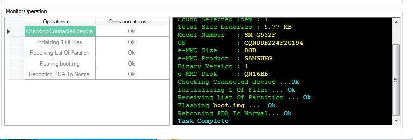

- Introduce either the AP file or the boot.img file of the phone here
- After creating the dongle file, it will open 2 folders for you, in one it is a root file and in the other it is a magisk file.
- Flash the root file on the phone from the SAMSUNG -> FLASH -> AP tab.
- If the phone asks you to factory reset the phone, do so
- After factory reset, take the phone directly. Download the mode and Flash the root file on the phone again and wait for the phone to turn on.
- Install the program that the dongle showed you on the phone
