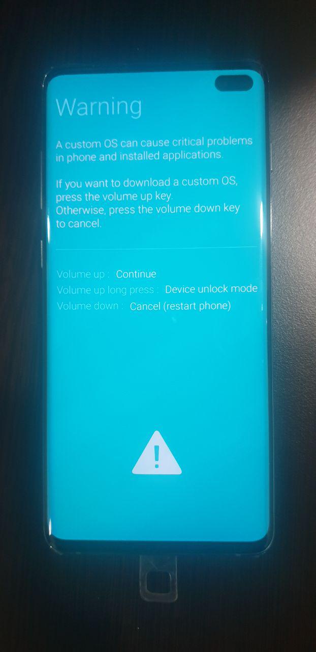

1 - Power off the device completely
2 - Press and hold on (Bixby) + (Volume Down) buttons then connect the usb cable with PC
Now you should see the download mode like this photo

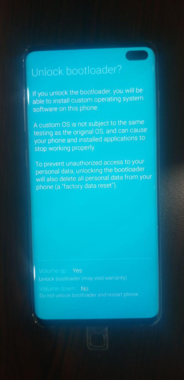

Now press Vol Up Untill See This Photo
Now press vol up till Restart
