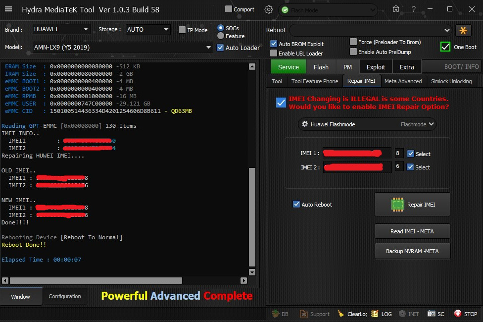

Huawei AMN-LX9 (Y5 2019) Both IMEI Repair Successfully done by Hydra Tool
1. Run Hydra MTK module.
2. Choose Brand and Module
3. Tick "Auto Broom Exploit"
4. Go to "Service" -->""IMEI" Tab.
5. Tick "IMEI changing is illigal............................".
6. Choose "Huawei Flash Mode" from drop down menu
7. Tick two small box, if you want to repair two IMEI
8. Type the imei written back on your cellphone or battery housing.
9. Tick "Auto Reboot"
10. Click "Execute"
11. connect device to the computer with USB Data cable
12. Wait until the process is completed.
