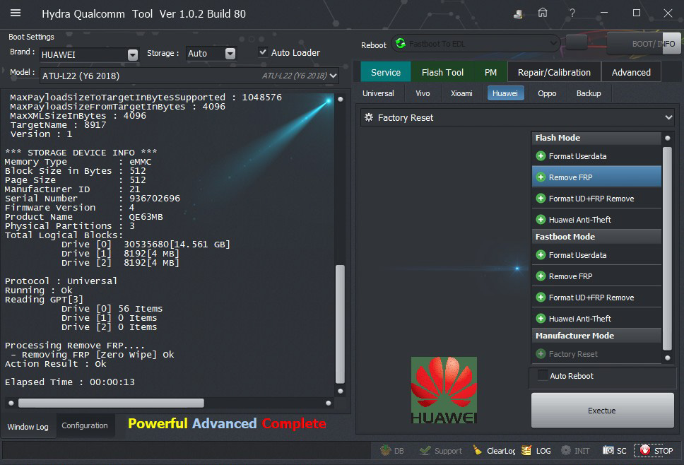

Huawei ATU-L22 (Y6 2018) Remove FRP successfully done by Hydra Tool
1. Run Qualcomm tool.
2. Choose Correct Module and Brand.
3. Go to "Service" -- > "Huawei"
4. Choose "Factory Reset" tool from drop down menu
5. choose "Remove FRP" from Flash Mode.
6. Click on "Execute" and connect device with computer using USB cable.
7. Wait until the process is completed.

Processing Remove FRP....
- Removing FRP [Zero Wipe] Ok
Action Result : Ok
Elapsed Time : 00:00:13
