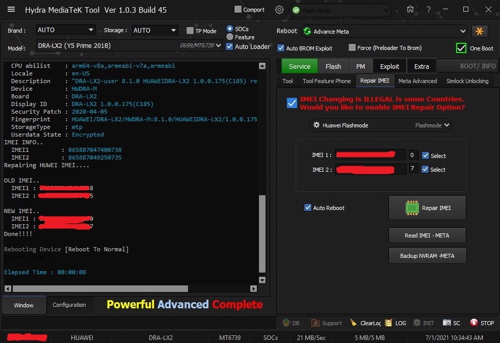

Huawei DRA-LX2 (Y5 Prime 2018) Both IMEI Repair successfully done by Hydra Tool
1. Run Hydra MTK Tool
2. Choose Brand and Module
3. Go to "Service"--> "Repair IMEI"
4. Tick "IMEI change....Illigal......
5. Choose "Huawei Flash Mode" from drop down menu.
6. Tick both IMEI to active box and type both IMEI as written in battery housing of the cellphone.
7. Click on "Repair IMEI"
8. Connect cellphone with computer using USB Data Cable.
9. Wait until the operation is completed.
