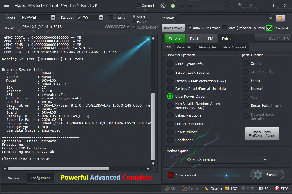

Huawei DRA-LX5 (Y5 Lite) 2018 formatting user data successfully done by Hydra Tool
1. Run Hydra MTK Module,
2. Select Brand and Model
3. Go to Service-->Tools-->Ultra Power Option
4. Choose "Erase UserData" from Method / Option
5. Execute and connect the device to the computer
6. wait until the process is completed.​
Huawei-DRA-LX5-Y5-Lite-2018-formatting-user-data-successfully-done-by-Hydra-Tool-edited.jpg
FriendlyName :MediaTek USB Port_V1632 (COM4)
SymbolicName :\??\USB#VID_0E8D&PID_0003#6&35cc635f&0&6#{a5dcbf10-6530-11d2-901f-00c04fb951ed}
UNIQUE ID : 3DBD65531C06F12EE914A65C0F16909C
ERAM Size : 0x0000000000020000 -128 KB
IRAM Size : 0x0000000040000000 -1024 MB
eMMC USER : 0x00000003A3E00000 -14.561 GB
eMMC CID : 150100464536324D4206312E975AA6DB - FE62MB
Reading System Info
Brand : HUAWEI
Vendor : HUAWEI
Model : DRA-LX5
SDK : 27
Release : 8.1.0
ABI : armeabi-v7a
Locale : en-US
Description : "DRA-LX5-user 8.1.0 HUAWEIDRA-LX5 1.0.0.149(C636) release-keys"
Device : HWDRA-MG
Board : DRA-LX5
Display ID : DRA-LX5 1.0.0.149(C636)
Security Patch : 2020-08-01
Fingerprint : HUAWEI/DRA-LX5/HWDRA-MG:8.1.0/HUAWEIDRA-LX5/1.0.0.149(C636):user/release-keys
StorageType : mtp
Userdata State : Encrypted
Operation : Erase Userdata
Processing...
Erasing FRP Partition...
Formatting Userdata... Ok
Elapsed Time : 00:00:05
