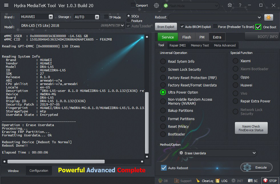

Huawei DRA-LX5 (Y5 Lite ) 2018 formatting user data successfully removed by Hydra Too
1. Run MTK tool of Hydra Dongle.
2. Choose Correct Module and Brand.
3. Go to "Service" -- > "Tool"
4. choose "Ultra Tool Option".
5. Choose "Erase user data" from "Method / Option" of drop down menu.
6. Click on "Execute" and connect device with computer using USB cable.
7. Wait until the process is completed.
BR=====================================
FriendlyName :MediaTek USB Port_V1632 (COM10)
SymbolicName :\??\USB#VID_0E8D&PID_0003#5&aeb40d0&0&6#{a5dcbf10-6530-11d2-901f-00c04fb951ed}
UNIQUE ID : 21E8C0DF3C52CF05B5143E8EA51C76B1
ERAM Size : 0x0000000000020000 -128 KB
IRAM Size : 0x0000000040000000 -1024 MB
eMMC USER : 0x00000003A3E00000 -14.561 GB
eMMC CID : 150100464536324D420686A06AFC6605 - FE62MB
Reading System Info
Brand : HUAWEI
Vendor : HUAWEI
Model : DRA-LX5
SDK : 27
Release : 8.1.0
ABI : armeabi-v7a
Locale : en-US
Description : "DRA-LX5-user 8.1.0 HUAWEIDRA-LX5 1.0.0.132(C636) release-keys"
Device : HWDRA-MG
Board : DRA-LX5
Display ID : DRA-LX5 1.0.0.132(C636)
Security Patch : 2019-07-05
Fingerprint : HUAWEI/DRA-LX5/HWDRA-MG:8.1.0/HUAWEIDRA-LX5/1.0.0.132(C636):user/release-keys
StorageType : mtp
Userdata State : Encrypted
Operation : Erase Userdata
Processing...
Erasing FRP Partition...
Formatting Userdata... Ok
Reboot Done!!
Elapsed Time : 00:00:06
