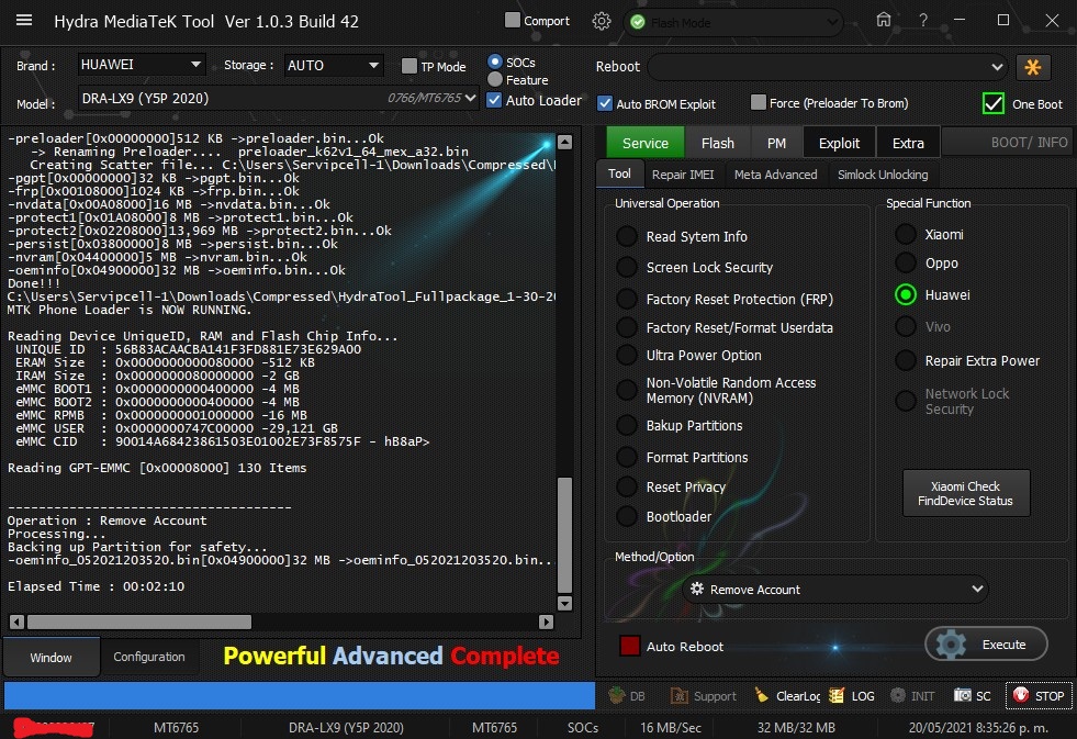

Huawei DRA-LX9 (Y5P 2020) account successfully removed by Hydra Tool
1. Run Hydra MTK Module and choose Sosc.
2. Choose Brand and Module.
3. Go to "Service"-->"Tool" Tab.
4. Choose "Huawei"
5. Choose "Remove Account" from "Module / Option" of drop down menu.
6. Click on "Execute"
8. connect device to the computer with USB Data cable
7. Wait until the process is completed.
4. Choose "Huawei"
Screen Shorts
Logs
FriendlyName :MediaTek USB Port (COM13)
Device :5&10190957&0&2
SymbolicName :\??\USB#VID_0E8D&PID_0003#5&10190957&0&2#{a5dcbf10-6530-11d2-901f-00c04fb951ed}
Driver Ver :01/22/2016,3.2
Handshaking...Ok
Identifying Hardware ID.....
Reading Device hardware info..
hw code : 0766MT6765 [6765]
hw subcode : 8A00
hw version : CA00
sw version : 0000
Target config : E5
SB : 01 (True)
SLA : 00 (False)
DAA : 04 (True)
Exploiting Device...
Exploit Sent..
Successfully Exploited...
Handshaking...Ok
hw subcode : 8A00
hw version : CA00
sw version : 0000
Target config : 00
SB : 00 (False)
SLA : 00 (False)
DAA : 00 (False)
FUSEID : 00000000
SECURE VERSION : 05
BL VERSION : FE
NORMAL BOOT
Preparing Download Agent..
DA : MT6765_Huawei_MED.bin
Ver : MTK_AllInOne_DA_v3.3001.2018/10/18.17:38_452898
Init : Loader [1]
Sending : Accepted
Identifying Protocol...
Protocol : New
Synchronization...[ERROR]- NOT SYNC
Reasons why it fails due to the following"
1. Harware problem/issues
2. If you did Testpoint Kindly check the parts you Touch/TP
3. Powershortage, try to connect Battery
4. Check or replace usb cable and plug directly to your pc usb port.
SYNC
Mode : brom
Preloader Initialization...
Parsing preloader_k62v1_64_mexico.bin
Init : Accepted
Execute Secondary Loader
Init : Loader [2]
Executing : SYNC
UNIQUE ID : 56B83ACAACBA141F3FD881E73E629A00
IRAM Size : 0x0000000080000000 -2 GB
eMMC USER : 0x0000000747C00000 -29,121 GB
eMMC CID : 90014A68423861503E01002E73F8575F - hB8aP>
DA Speed : high-speed
Autobackup Partitions
-> Renaming Preloader.... preloader_k62v1_64_mex_a32.bin
Creating Scatter file... C:\Users\Servipcell-1\Downloads\Compressed\HydraTool_Fullpackage_1-30-2021\\Backup\Auto\0766__052021203458\MT6765_Android_scatter.txt
-frp[0x00108000]1024 KB ->frp.bin...Ok
-nvdata[0x00A08000]16 MB ->nvdata.bin...Ok
-protect1[0x01A08000]8 MB ->protect1.bin...Ok
-protect2[0x02208000]13,969 MB ->protect2.bin...Ok
-persist[0x03800000]8 MB ->persist.bin...Ok
-nvram[0x04400000]5 MB ->nvram.bin...Ok
-oeminfo[0x04900000]32 MB ->oeminfo.bin...Ok
Done!!!
Operation : Remove Account
Processing...
Backing up Partition for safety...
-oeminfo_052021203520.bin[0x04900000]32 MB ->oeminfo_052021203520.bin...Ok Ok
Elapsed Time : 00:02:10
