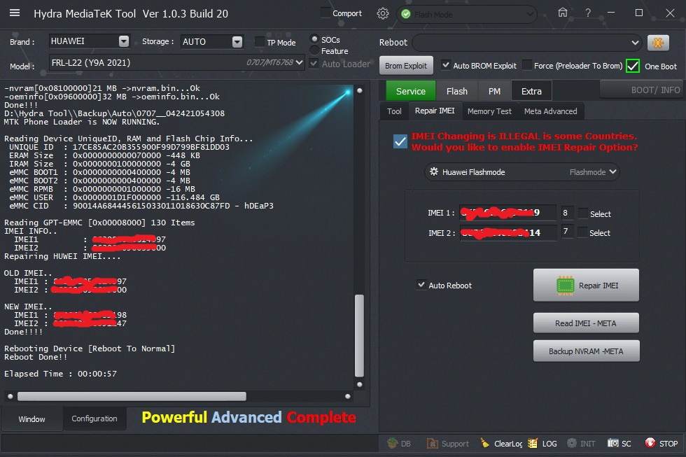

Hydra Huawei FRL-L22 (Y9A 2021) Repair IMEI successfully done by Hydra Tool
549
1. Run Hydra MTK Module,
2. Select Brand and Model
3. Go to Service-->Repair IMEI
4. Choose The device FLASH MODE and type IMEI written on Battery Housing
5. Execute and connect the device to the computer
6. wait until the process is completed.​
***IMEI REPAIR FUNCTION****
Huawei Flashmode
FriendlyName :MediaTek USB Port_V1632 (COM13)
SymbolicName :\??\USB#VID_0E8D&PID_0003#6&2e98c2b&0&1#{a5dcbf10-6530-11d2-901f-00c04fb951ed}
Handshaking...Ok
Identifying Hardware ID.....
BROM CPUID : 0707MT6768[6768]
getMTKPayloadExploit : 0707
#Executing Exploit..
#SUCCESS..
Handshaking...Ok
FUSEID : 00000000
SECURE VERSION : 00
BL VERSION : FE
BR Secured : E0
Preparing Download Agent..
DA : MT6768_Xiaomi_New.bin
Ver : MTK_AllInOne_DA_v3.3001.2020/07/07.10:10_513994
Init : Loader [1]
Sending : Accepted
Identifying Protocol...
Protocol : New
Synchronization...SYNC
Mode : brom
Preloader Initialization...
Parsing preloader_k69v1_64.bin
Init : Accepted
Execute Secondary Loader
Init : Loader [2]
Executing : SYNC
UNIQUE ID : 17CE85AC20B355900F99D799BF81DD03
eMMC USER : 0x0000001D1F000000 -116.484 GB
eMMC CID : 90014A684445615033011018630C87FD - hDEaP3
DA Speed : high-speed
Autobackup Partitions
-> Renaming Preloader.... preloader_k69v1_64.bin
Creating Scatter file... D:\Hydra Tool\\Backup\Auto\0707__042421054308\MT6768_Android_scatter.txt
-frp[0x01A08000]1024 KB ->frp.bin...Ok
-nvdata[0x03B08000]32 MB ->nvdata.bin...Ok
-persist[0x07800000]8 MB ->persist.bin...Ok
-nvram[0x08100000]21 MB ->nvram.bin...Ok
-oeminfo[0x09600000]32 MB ->oeminfo.bin...Ok
Done!!!
IMEI INFO..
IMEI1 : *************97
IMEI2 : *************00
Repairing HUWEI IMEI....
OLD IMEI..
NEW IMEI..
IMEI1 : *************98
IMEI2 : *************47
Done!!!!
Reboot Done!!
Elapsed Time : 00:00:57
