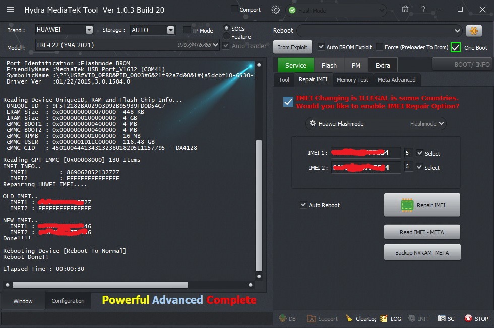

Hydra Huawei FRL-L22 (Y9A 2021) Repair IMEI successfully done by Hydra Tool
550
Huawei FRL-L22 (Y9A 2021) Repair Both IMEI successfully done by Hydra Tool
1. Run Hydra MTK Module and choose Sosc.
2. Choose Brand and Module.
3. Go to "Service"-->"Repair IMEI" Tab.
4. Tick "IMEI changing........................."
5. Choose "Huawei FlashMode" from drop down menu.
6. Type Both IMEI written as in battery housing and tick both of box
7. Click on "Repair IMEI"
8. connect device to the computer with USB Data cable
9. Wait until the process is completed.
***IMEI REPAIR FUNCTION****
Huawei Flashmode
FriendlyName :MediaTek USB Port_V1632 (COM41)
SymbolicName :\??\USB#VID_0E8D&PID_0003#6&21f92a7d&0&1#{a5dcbf10-6530-11d2-901f-00c04fb951ed}
UNIQUE ID : 9F5F2182BA02903D92B95939FD0D54C7
eMMC USER : 0x0000001D1EC00000 -116.48 GB
eMMC CID : 4501004441343132380182D5E1157795 - DA4128
IMEI INFO..
IMEI1 : ***************27
IMEI2 : FFFFFFFFFFFFFFF
Repairing HUWEI IMEI....
OLD IMEI..
IMEI1 : **************27
NEW IMEI..
IMEI1 : *************46
IMEI2 : *************46
Done!!!!
Reboot Done!!
Elapsed Time : 00:00:30
