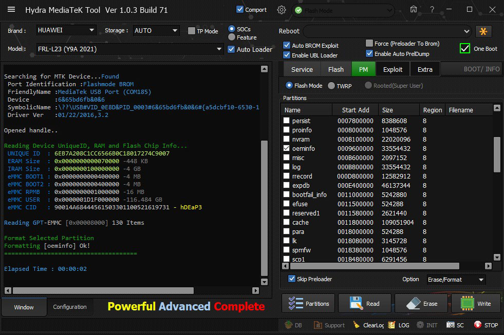

Huawei FRL-L23 (Y9A 2021) formatting selected partition successfully done by Hydra
1. Run MTK Tool and choose "Sosc"
2. Choose Brand and Module.
3. Go to "Service"--> "Tool"
4. Tick "ComPort"
5. Tick "Auto Broom Exploit" and "Enable UBL Loader" and "
Enable auto preEump"
6. Choose "PM" Tab
7. Choose "Flash Mode"
8. Click on "Partition"
9. Connect device to computer using USB Data Cable.
10. Wait until the operation shows the all partition of you cellphone.
11. Choose "OEMinfo"
12. Click "Erase" to remove it. If you want to read it, then, click "Read" and if you want to write it click on "Write"
13. Wait until the operation is completed.
