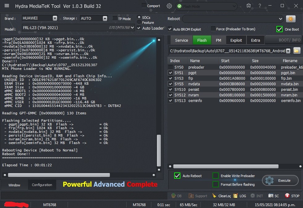

Hydra Huawei FRL-L23 (Y9A 2021) selected partition successfully flashed by Hydra Tool
550
Huawei FRL-L23 (Y9A 2021) selected partition successfully flashed by Hydra Tool​
1. Run MTK Tool and choose "Sosc"
2. Choose Brand and Module.
3. Go to "Flash"-TaB
4. Choose Flash file or selected file from here.
5. Tick "Auto Reboot" and click "Execute"
6. Connect device to computer using USB Data Cable.
7. Wait until the operation is completed.
Screen Shorts
Logs​
Brand : HUAWEI Model : FRL-L23 (Y9A 2021) Connection : Flash Mode
How To Boot : Power off phone
* BROM Mode : Press VOL + or Press VOL -+
FriendlyName :MediaTek USB Port (COM18)
Device :6&1c7d0d6&0&3
SymbolicName :\??\USB#VID_0E8D&PID_0003#6&1c7d0d6&0&3#{a5dcbf10-6530-11d2-901f-00c04fb951ed}
Driver Ver :01/22/2016,3.2
Handshaking...Ok
Identifying Hardware ID.....
Reading Device hardware info..
hw code : 0707MT6768 [6768]
hw subcode : 8A00
hw version : CA00
sw version : 0000
Target config : E5
SB : 01 (True)
SLA : 00 (False)
DAA : 04 (True)
Exploiting Device...
Successfully Exploited...
Handshaking...Ok
hw subcode : 8A00
hw version : CA00
sw version : 0000
Target config : 00
SB : 00 (False)
SLA : 00 (False)
DAA : 00 (False)
FUSEID : 00000000
SECURE VERSION : 00
BL VERSION : FE
NORMAL BOOT
Preparing Download Agent..
DA : MT6768_Xiaomi_New.bin
Ver : MTK_AllInOne_DA_v3.3001.2020/07/07.10:10_513994
Init : Loader [1]
Sending : Accepted
Identifying Protocol...
Protocol : New
Synchronization...SYNC
Mode : brom
Preloader Initialization...
Parsing preloader_k69v1_64.bin
Init : Accepted
Execute Secondary Loader
Init : Loader [2]
Executing : SYNC
UNIQUE ID : DD1E9976218F701269CAF674DC6063D2
eMMC USER : 0x0000001D1EC00000 -116.48 GB
eMMC CID : 150100445554423432022513C06A97B3 - DUTB42
DA Speed : high-speed
Autobackup Partitions
-> Renaming Preloader.... preloader_k69v1_64.bin
Creating Scatter file... C:\hydratool\\Backup\Auto\0707__051521201307\MT6768_Android_scatter.txt
-frp[0x01A08000]1024 KB ->frp.bin...Ok
-nvdata[0x03B08000]32 MB ->nvdata.bin...Ok
-persist[0x07800000]8 MB ->persist.bin...Ok
-nvram[0x08100000]21 MB ->nvram.bin...Ok
-oeminfo[0x09600000]32 MB ->oeminfo.bin...Ok
Done!!!
- pgpt[pgpt.bin] 32 KB Flash -> = Ok
- frp[frp.bin] 1024 KB Flash -> = Ok
- nvdata[nvdata.bin] 32 MB Flash -> = Ok
- persist[persist.bin] 8 MB Flash -> = Ok
- nvram[nvram.bin] 21 MB Flash -> = Ok
- oeminfo[oeminfo.bin] 32 MB Flash -> = Ok
Reboot Done!!
Elapsed Time : 00:01:22
