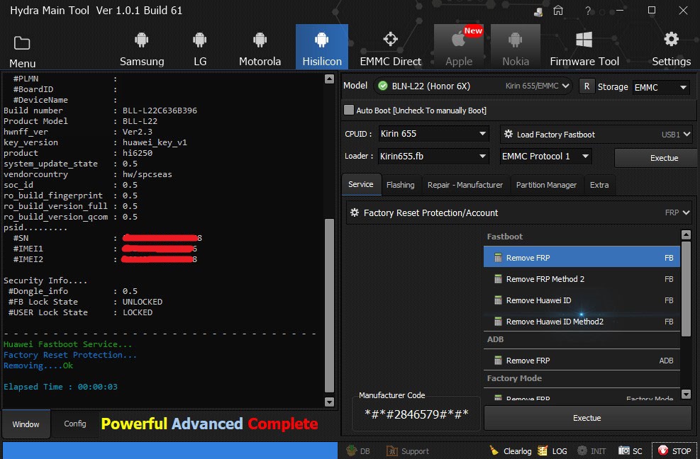

Huawei Hisilicon BLN-L22 (Honor 6X) Remove FRP successfully done by Hydra Tool
1. Run Hydra Main Tool.
2. Choose "Hisilicon" Tab.
3. Choose "Module"
4. UnTick "Auto Boot" and Choose Manual BOOT as shown below
CPU id : Kirin655
Loader : Kirin655.fb
5. Choose "Service" Tab
6. Choose "Factory Reset Protection / Account" from drop down menu.
7. Choose "Remove FRP"
8. Click on "Execute"
9. Connect the device to the compute with the help of Data Cable.
10. Wait until the operation is completed.
