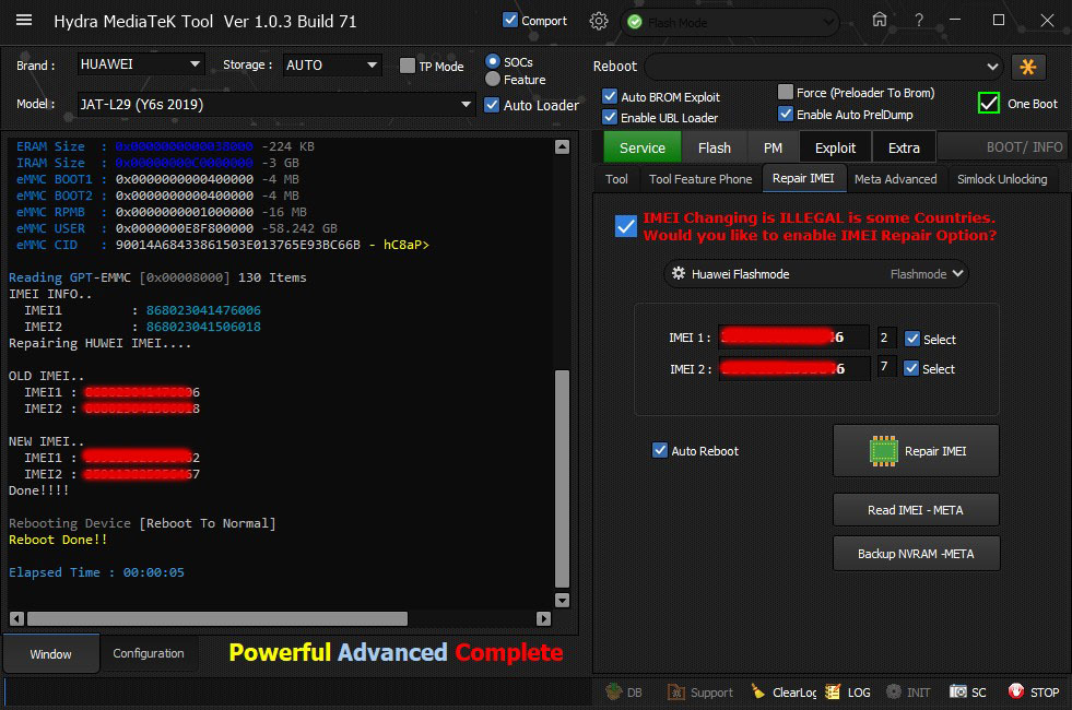

Huawei JAT-L29 (Y6s 2019) Both IMEI repaired Successfully done by Hyhdra Tool
1. Run Hydra MTK Module and choose Sosc.
2. Choose Brand and Module.
3. Tick "Auto Broom Exploit", "Enable UBL Loader" and "Enable Auto PreDUMP"
4. Go to "Service"->"Repair IMEI" Tab.
5. Tick "IMEI changing ……………………."
6. Choose "Huawei FlashMode" from the drop down menu.
7. Type both IMEI written in battery housing and tick both of the boxes
8. Click on "Repair IMEI"
9. Connect the computer to the USB data cable
10. Wait until the process is complete.
