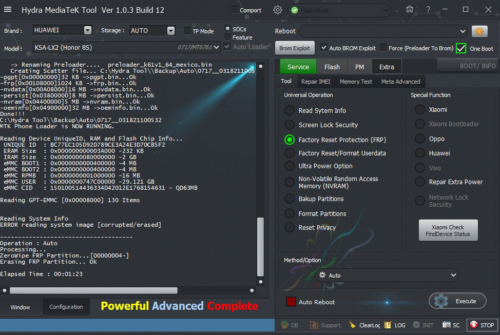

Hydra Huawei KSA-LX2 (Honor 8S) FRP partition successfully removed by Hydra Tool
550
FriendlyName :MediaTek USB Port_V1633 (COM5)
SymbolicName :\??\USB#VID_0E8D&PID_0003#5&1a0dde74&0&2#{a5dcbf10-6530-11d2-901f-00c04fb951ed}
Handshaking...Ok
Identifying Hardware ID.....
BROM CPUID : 0717MT6761[6761]
BROM HW_SW_VER : 8A00 CA01 0200 0000
getMTKPayloadExploit : 0717
#Executing Exploit..
#SUCCESS..
Handshaking...Ok
FUSEID : 00000000
SECURE VERSION : 00
BL VERSION : FE
BR Secured : E0
Preparing Download Agent..
DA : 6761.bin
Ver : MTK_AllInOne_DA_v3.3001.2020-11-03.22:07_536568
Init : Loader [1]
Sending : Accepted
Identifying Protocol...
Protocol : New
Synchronization...[ERROR]- NOT SYNC
Reasons why it fails due to the following"
1. Harware problem/issues
2. If you did Testpoint Kindly check the parts you Touch/TP
3. Powershortage, try to connect Battery
4. Check or replace usb cable and plug directly to your pc usb port.
SYNC
Mode : brom
Preloader Initialization...
Parsing preloader_k61v1_64_mexico.bin
Init : Accepted
Execute Secondary Loader
Init : Loader [2]
Executing : SYNC
UNIQUE ID : BC77EC105D92D789CE3A24E3D70CB5F2
ERAM Size : 0x000000000003A000 -232 KB
IRAM Size : 0x0000000080000000 -2 GB
eMMC CID : 150100514436334D42012E1768154631 - QD63MB
DA Speed : high-speed
Reading System Info
ERROR reading system image [corrupted/erased]
Autobackup Partitions
-> Renaming Preloader.... preloader_k61v1_64_mexico.bin
Creating Scatter file... C:\Hydra Tool\\Backup\Auto\0717__031821100532\MT6761_Android_scatter.txt
-frp[0x00108000]1024 KB ->frp.bin...Ok
-nvdata[0x00A08000]16 MB ->nvdata.bin...Ok
-persist[0x03800000]8 MB ->persist.bin...Ok
-nvram[0x04400000]5 MB ->nvram.bin...Ok
-oeminfo[0x04900000]32 MB ->oeminfo.bin...Ok
Done!!!
Reading System Info
Operation : Auto
Processing...
ZeroWipe FRP Partition...[00000004-]
Erasing FRP Partition... Ok
Elapsed Time : 00:01:23
