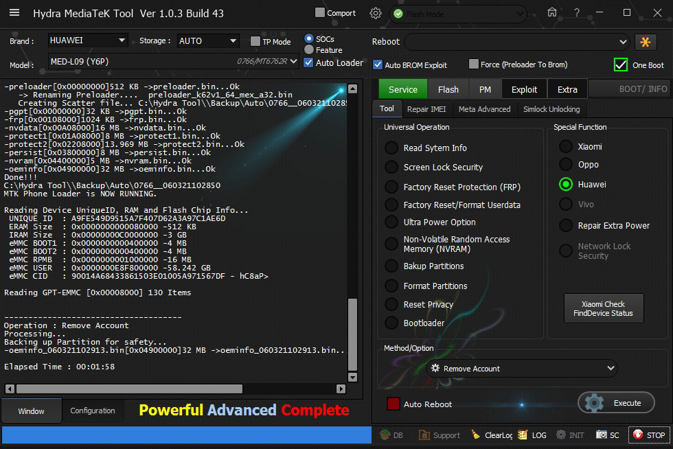

Huawei MED-L09 (Y6P) Remove Account is successfully done by Hydra Tool
1. Run Hydra MTK Module and choose "Sosc"
2. Select Brand and Model
3. Go to Service-->Tool
4. Choose "Huwei".
5. Choose "Remove Account" from "Option / Method" drop down menu
6. Click on "Execute".
7. connect the device to the computer with data cable
8. wait until the process is completed.

Operation : Remove Account
Processing...
Backing up Partition for safety...
-oeminfo_060321102913.bin[0x04900000]32 MB ->oeminfo_060321102913.bin...Ok Ok
Elapsed Time : 00:01:58
