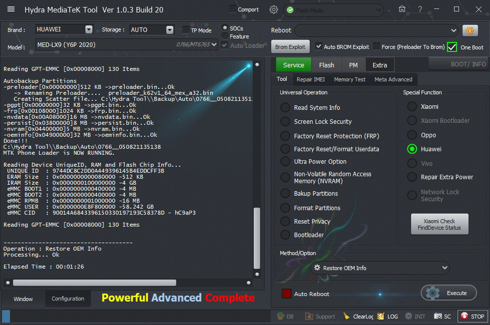

Huawei MED-LX9 (Y6P 2020) restoring OEM info successfully done by Hydra Tool
1. Run MTK tool of Hydra Dongle.
2. Choose Correct Module and Brand.
3. Go to "Service" -- > "Tool"
4. choose "Huawei".
5. Choose "Restore OEM info" from "Method / Option" of drop down menu.
6. Click on "Execute" and connect device with computer using USB cable.
7. Wait until the process is completed.
4. choose "Huawei".
BR=====================================
FriendlyName :MediaTek USB Port_V1633 (COM5)
SymbolicName :\??\USB#VID_0E8D&PID_0003#5&27926011&0&2#{a5dcbf10-6530-11d2-901f-00c04fb951ed}
Handshaking...Ok
Identifying Hardware ID.....
BROM CPUID : 0766MT6765[6765]
getMTKPayloadExploit : 0766
#Executing Exploit..
#SUCCESS..
Handshaking...Ok
FUSEID : 00000000
SECURE VERSION : 05
BL VERSION : FE
BR Secured : E0
Preparing Download Agent..
DA : MT6765_Huawei_MED.bin
Ver : MTK_AllInOne_DA_v3.3001.2018/10/18.17:38_452898
Init : Loader [1]
Sending : Accepted
Identifying Protocol...
Protocol : New
Synchronization...[ERROR]- NOT SYNC
Reasons why it fails due to the following"
1. Harware problem/issues
2. If you did Testpoint Kindly check the parts you Touch/TP
3. Powershortage, try to connect Battery
4. Check or replace usb cable and plug directly to your pc usb port.
SYNC
Mode : brom
Preloader Initialization...
Parsing preloader_k62v1_64_mexico.bin
Init : Accepted
Execute Secondary Loader
Init : Loader [2]
Executing : SYNC
UNIQUE ID : 9744DC8C2DD0A449396145B4EDDCFF3B
eMMC CID : 90014A6843396150330197193C58378D - hC9aP3
DA Speed : high-speed
Autobackup Partitions
-> Renaming Preloader.... preloader_k62v1_64_mex_a32.bin
Creating Scatter file... C:\Hydra Tool\\Backup\Auto\0766__050821135138\MT6765_Android_scatter.txt
-frp[0x00108000]1024 KB ->frp.bin...Ok
-nvdata[0x00A08000]16 MB ->nvdata.bin...Ok
-persist[0x03800000]8 MB ->persist.bin...Ok
-nvram[0x04400000]5 MB ->nvram.bin...Ok
-oeminfo[0x04900000]32 MB ->oeminfo.bin...Ok
Done!!!
Operation : Restore OEM Info
Processing... Ok
Elapsed Time : 00:01:26
