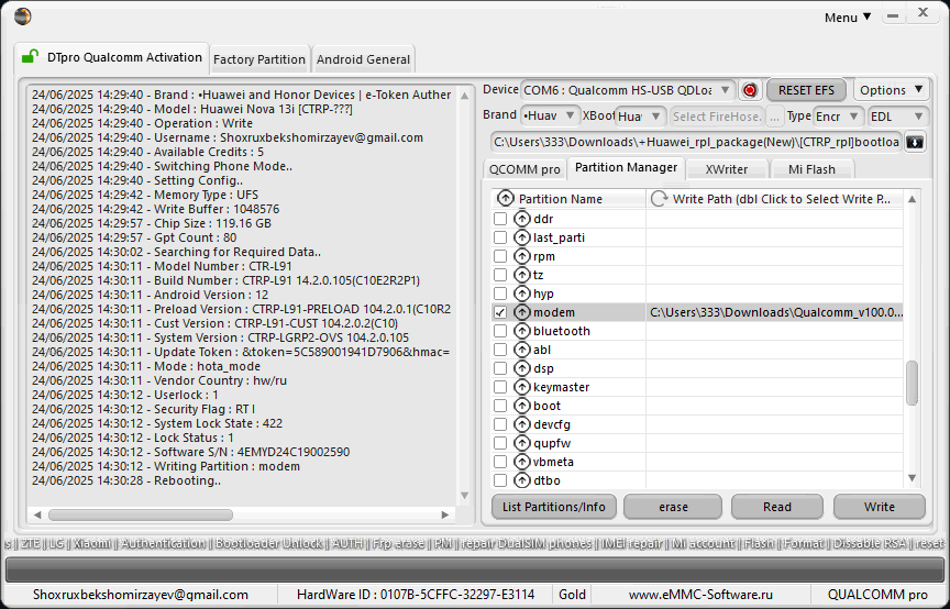

This Device [Huawei Nova 13i] requires network repair.
•This operation requires credits!
Press [YES] to continue
Connect in Edl Mode again!.. and go to the Partition Manager tab!...
Press Info | List Partition Button
Locate the Modem Partition and double-click to load the Modem.
Once the modem is loaded into the partition table, please press the Write button!
wait for the operation to complete.
