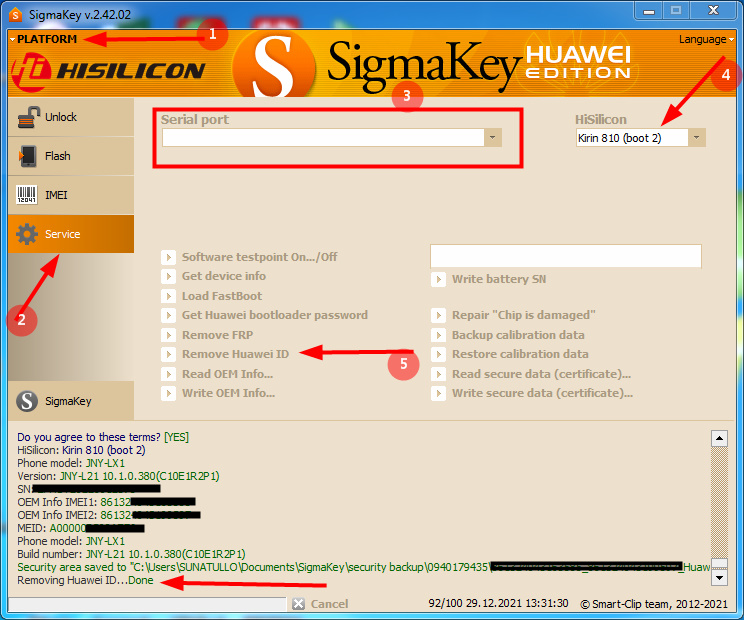

SigmaKey 2.42.02 HiSi: Remove Huawei ID
HUAWEI USB COM 1.0 (COM6), Provider: HUAWEI Incorporated, Driver ver.: 2.0.6.725, Date: 10.08.2014, USB\VID_12D1&PID_3609&REV_0100
Terms of Remove Huawei ID operation:
1) 90 authorizations will be deducted from your account (non-refundable).
2) The battery must be connected to the phone's board and fully charged.
Do you agree to these terms? [YES]
HiSilicon: Kirin 810 (boot 2)
Phone model: JNY-LX1
Version: JNY-L21 10.1.0.380(C10E1R2P1)
SN: EPHUT20226012375
OEM Info IMEI1: 861324043163585
OEM Info IMEI2: 861324043199597
MEID: A00000B508AE76
Build number: JNY-L21 10.1.0.380(C10E1R2P1)
Security area saved to "C:\Users\SUNATULLO\Documents\SigmaKey\security backup\0940179435\861324043163585_861324043199597_Huawei_JNY-LX1_JNY-L21 10_1_0_380(C10E1R2P1).skb"
Removing Huawei ID...Done

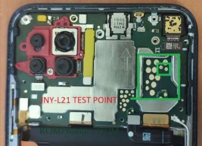

JNY-LX1 TEST POINT
Harmony TP Cable​
