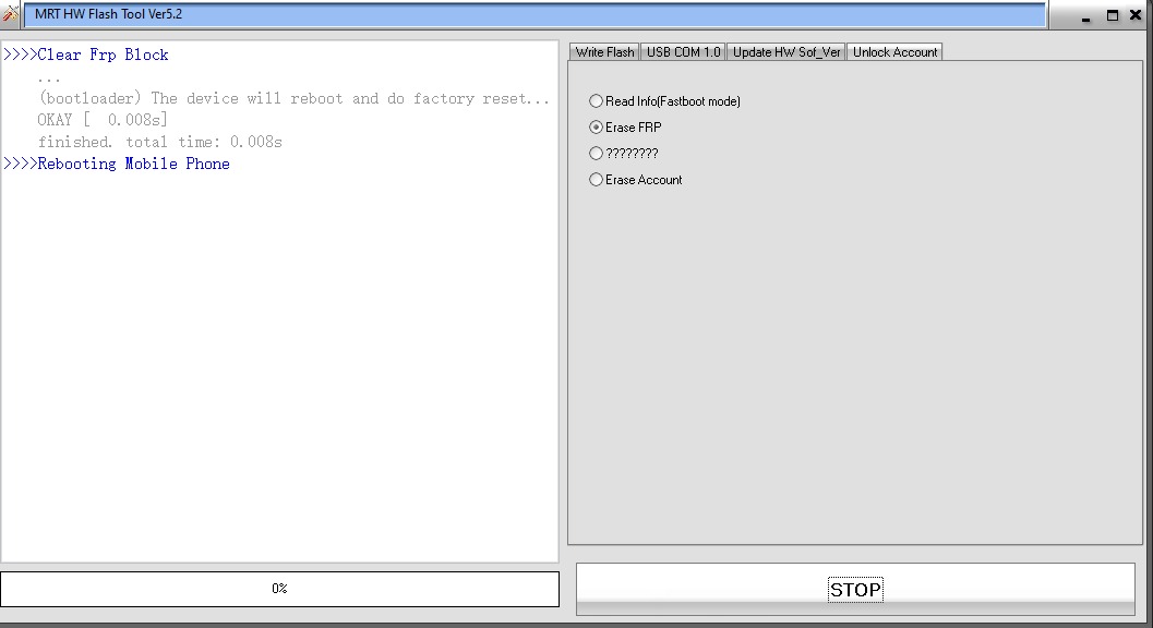

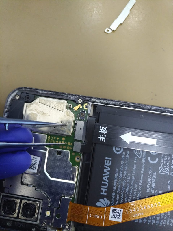

Short this Test point for com 1.0 port :
Procedure:
  1. Got to COM 1.0 tab
  2. Select CPU (Here 970)
  3. Click Start
  4. Now device will boot to fastboot with unlocked boot loader
  5. Go to Unlock Account Tab
  6. Select Erase FRP
  7. Click start
  8. Done

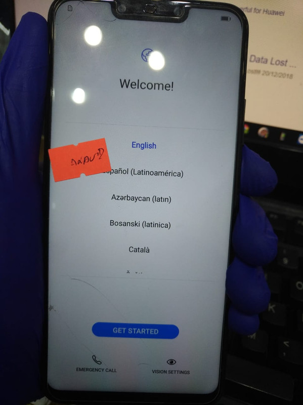

  9. Device will reboot and FRP will be removed
