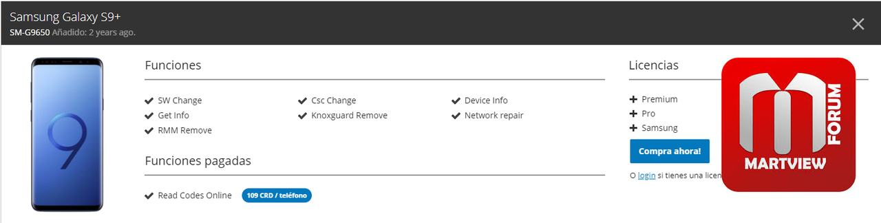

I have a chimera tool pro perata.
But in Chimera it gives me only these options to work
The remove knox and Remove RMM do not appear to me
remove knox & rmm in chimera with adb mode not in download mode
you phone has passwword this method not work for you
