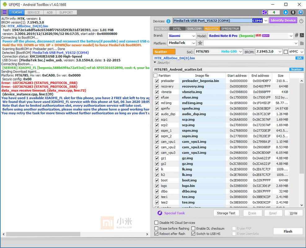

atstech
@support
im trying to load an mtk scatter file and i get this error! ive tried different files as well but same? pls inform the solution!
wbr
