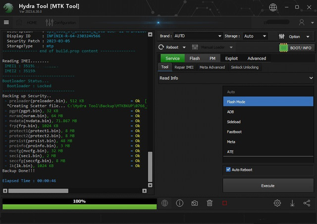

Bootloader Status...
  Bootloader : Locked
Backing up Security..
- preloader(preloader.bin), 512 KB                    = Ok  [preloader_x688b_h659.bin]
  *Creating Scatter file... C:\Hydra Tool\Backup\MTKBKUP\0766_C7A1244A614C26FA5DA72920EAE9FA3D4\Auto\072123120006\6765_Android_scatter.txt
- pgpt(pgpt.bin), 32 KB                               = Ok
- nvram(nvram.bin), 64 MB                             = Ok
- nvdata(nvdata.bin), 71.867 MB                       = Ok
- frp(frp.bin), 1024 KB                               = Ok
- protect1(protect1.bin), 8 MB                        = Ok
- protect2(protect2.bin), 8 MB                        = Ok
- persist(persist.bin), 48 MB                         = Ok
- proinfo(proinfo.bin), 3 MB                          = Ok
- nvcfg(nvcfg.bin), 32 MB                             = Ok
- sec1(sec1.bin), 2 MB                                = Ok
- seccfg(seccfg.bin), 8 MB                            = Ok
- lk(lk.bin), 1024 KB                                 = Ok
Backup Done!!!
Elapsed Time : 00:00:46
- Select FRP Lock remove and click execute

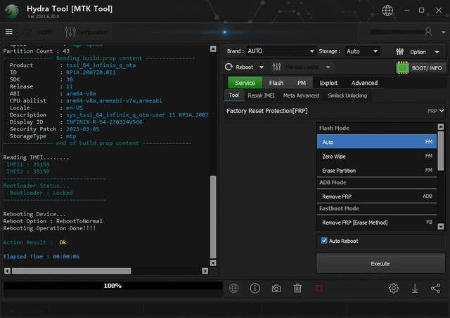

                      Service Function
               Factory Reset Protection[FRP]
                            Auto
  MTK Port Type   : Flashmode BROM
  FriendlyName    : MediaTek USB Port_V1633 (COM7)
  Device          : /7&315b3d0&0&2
  SymbolicName    : \\?\usb#vid_0e8d&pid_0003#7&315b3d0&0&2#{a5dcbf10-6530-11d2-901f-00c04fb951ed}
  Driver Ver      : 01/22/2015,3.0.1504.0
  Service         : wdm_usb
Openning Port [COM7] Ok
Reading Partition Table ..
  ERAM Size       : 0x000000000003A000-232 KB
  IRAM Size       : 0x0000000100000000-4 GB
  EMMC RPMB Size  : 0x0000000001000000-16 MB
  EMMC USER Size  : 0x0000000E8F800000-58.242 GB
  EMMC CID        : 90014A6843396150330100A11F7CC78F - hC9aP3
  HW-CODE         : 0x766
  HWSUB-CODE      : 0x8A00
  HW-VERSION      : 0xCA00
  SW-VERSION      : 0x0
  CHIP-EVOLUTION  : 0x0
  DA-VERSION      : 1.0
  Speed           : high-speed
Partition Count : 43
  Product        : tssi_64_infinix_q_ota
  SDK            : 30
  Release        : 11
  ABI            : arm64-v8a
  CPU abilist    : arm64-v8a,armeabi-v7a,armeabi
  Locale         : en-US
  Description    : sys_tssi_64_infinix_q_ota-user 11 RP1A.200720.011 282776 release-keys
  Display ID     : INFINIX-R-64-230324V566
  Security Patch : 2023-03-05
  StorageType    : mtp
Reading IMEI........
IMEI1 : 35159**********
IMEI2 : 35159**********
  Bootloader : Locked
Rebooting Device...
Rebooting Operation Done!!!!
Action Result :  Ok
