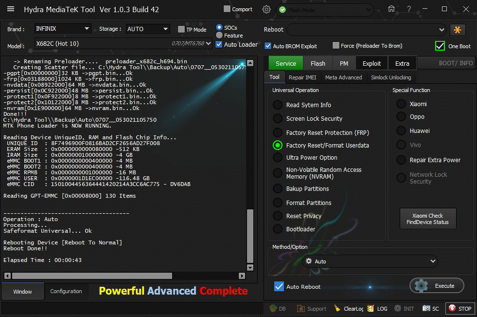

Infix X682C (HOT 10) safe format universal OKAY by Hydra Tool
1. Run MTK Tool and choose "Sosc"
2. Choose Brand and Module as "Auto"
3. Go to "Service"--> "Tool" from Universal Option
4. Choose "Factory Reset / Format user data"
5. Choose "Auto" from "Method / Option" drop down menu.
6. Connect device to computer using USB Data Cable.
7. Wait until the operation is completed
FriendlyName :MediaTek USB Port_V1632 (COM4)
Device :5&1ba1e768&0&2
SymbolicName :\??\USB#VID_0E8D&PID_0003#5&1ba1e768&0&2#{a5dcbf10-6530-11d2-901f-00c04fb951ed}
Handshaking...Ok
Identifying Hardware ID.....
Reading Device hardware info..
hw code : 0707MT6768 [6768]
hw subcode : 8A00
hw version : CA00
sw version : 0000
Target config : E5
SB : 01 (True)
SLA : 00 (False)
DAA : 04 (True)
Exploiting Device...
Exploit Sent..
Successfully Exploited...
Handshaking...Ok
hw subcode : 8A00
hw version : CA00
sw version : 0000
Target config : 00
SB : 00 (False)
SLA : 00 (False)
DAA : 00 (False)
FUSEID : 00000000
SECURE VERSION : 00
BL VERSION : FE
NORMAL BOOT
Preparing Download Agent..
DA : [Not Exist]
Trying Default 6768.bin
Ver : MTK_AllInOne_DA_v3.3001.2020/03/17.上午10:04_497508
Init : Loader [1]
Sending : Accepted
Identifying Protocol...
Protocol : New
Synchronization...SYNC
Mode : brom
Preloader Initialization...
Parsing preloader_x692_h694.bin
Init : Accepted
Execute Secondary Loader
Init : Loader [2]
Executing : SYNC
UNIQUE ID : 8F7496900F0816BAD2CF2656AD27F008
eMMC USER : 0x0000001D1EC00000 -116.48 GB
eMMC CID : 1501004456364441420214A3CC6AC775 - DV6DAB
DA Speed : high-speed
Autobackup Partitions
-> Renaming Preloader.... preloader_x682c_h694.bin
Creating Scatter file... C:\Hydra Tool\\Backup\Auto\0707__053021105750\MT6768_Android_scatter.txt
-frp[0x03188000]1024 KB ->frp.bin...Ok
-nvdata[0x08922000]64 MB ->nvdata.bin...Ok
-persist[0x0C922000]48 MB ->persist.bin...Ok
-protect1[0x0F922000]8 MB ->protect1.bin...Ok
-protect2[0x10122000]8 MB ->protect2.bin...Ok
-nvram[0x1E900000]64 MB ->nvram.bin...Ok
Done!!!
Operation : Auto
Processing...
Safeformat Universal... Ok
Reboot Done!!
Elapsed Time : 00:00:43
