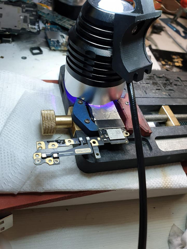

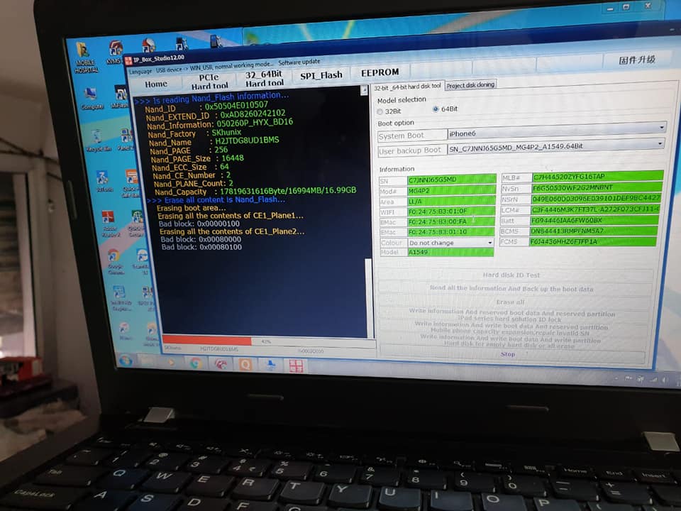

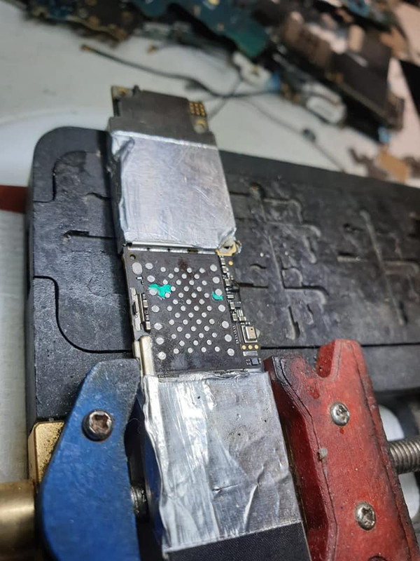

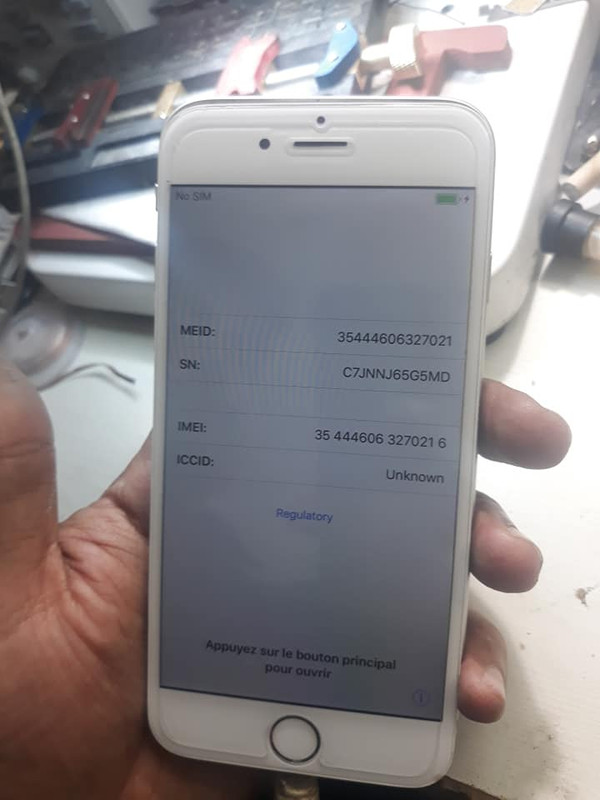

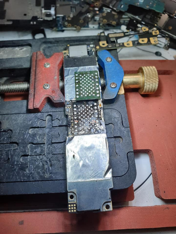

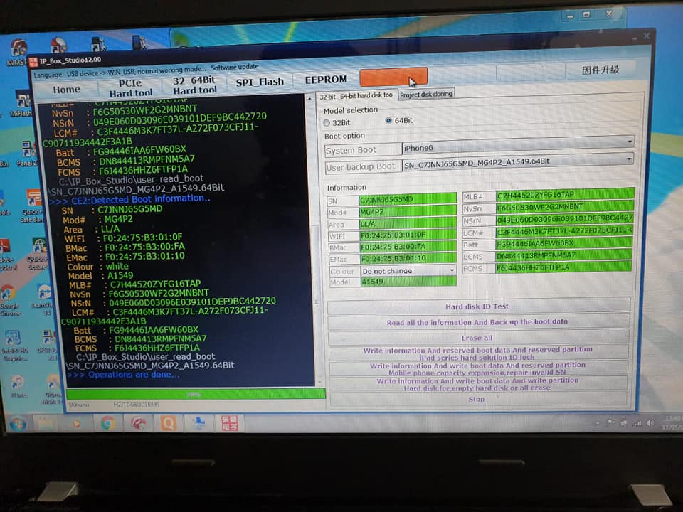

IPhone 6 Error 9 Done By Nand Re-Program

hi my brother i really appreciate your work on nand repair but a question and to know to correct error 9 you just fix nand with one. programmer or you changed the nand because i also had fix error 9 i just replace another nand but i will more explanation on your best post

My Friend In New IOS Update Apple Change Error Code 4013 To Error 9 ...Error 9 Also Came When Track From CPU Break So 1st Trace Your Phone Issue...If Track Missing Drill If Track Ok Re-Program Nand It Will Be Work...(If I Am Wrong Kindly Correct Me I Am New To Iphones World) ;-)

Yes in come when I2C_SCL I2C_SDA tracks are missing
only in PCIE error code 4013 is changed in error 9 not in NAND
