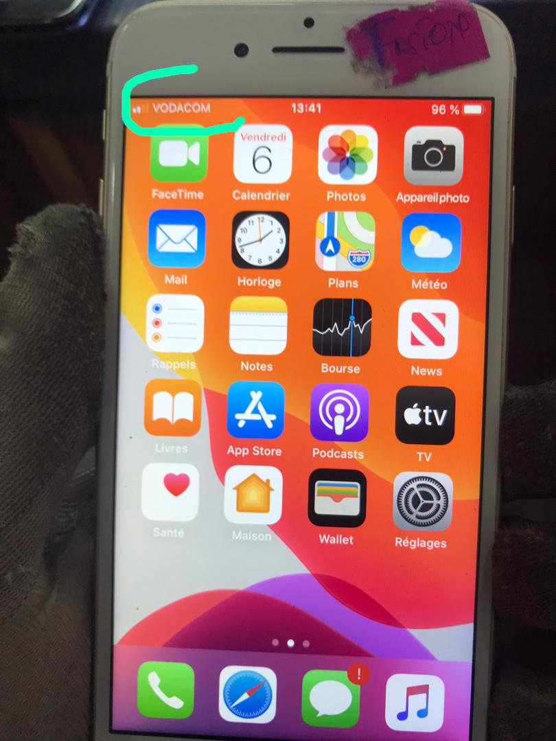

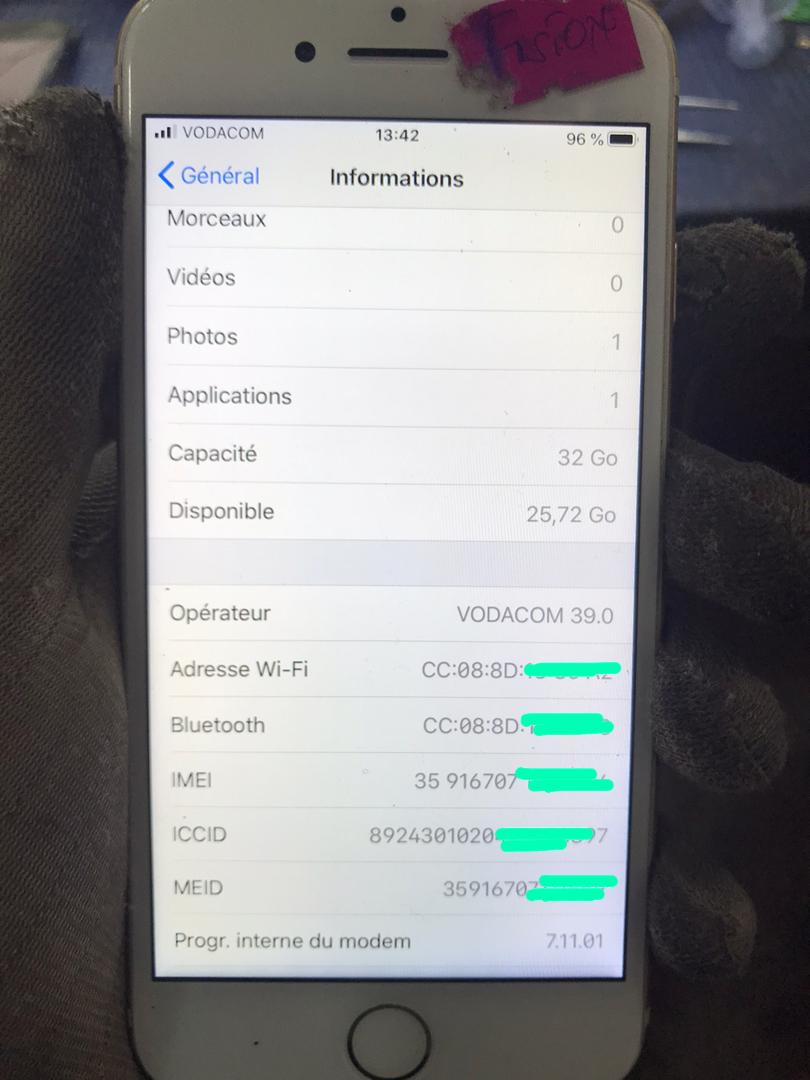

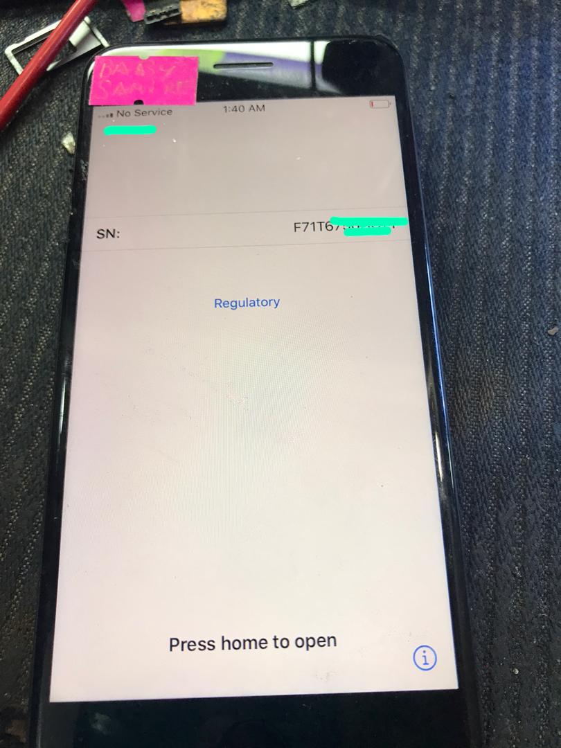

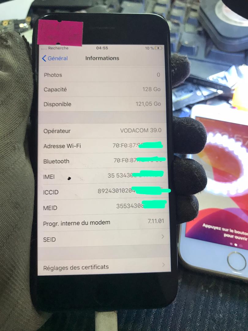

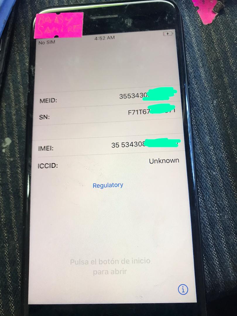

iPhone 7 #No_service [emoji3544] resolved [emoji736]

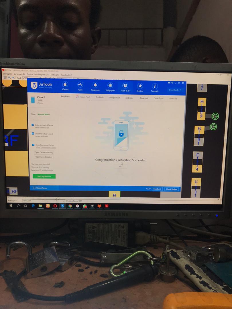

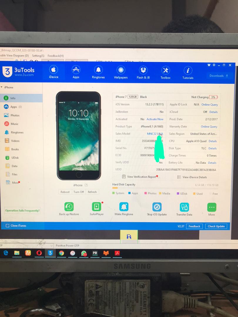

Unable to activate blocks on triangle

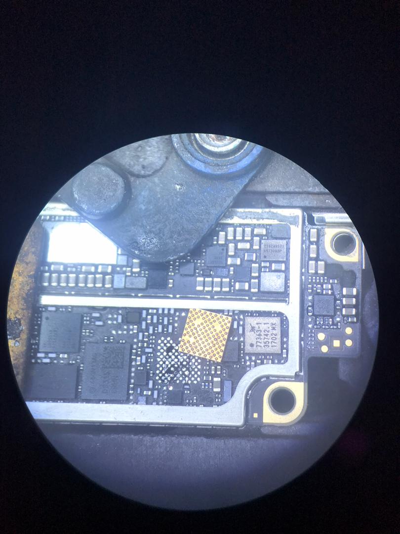

I just repairing two iPhone 7 (Qualcomm)

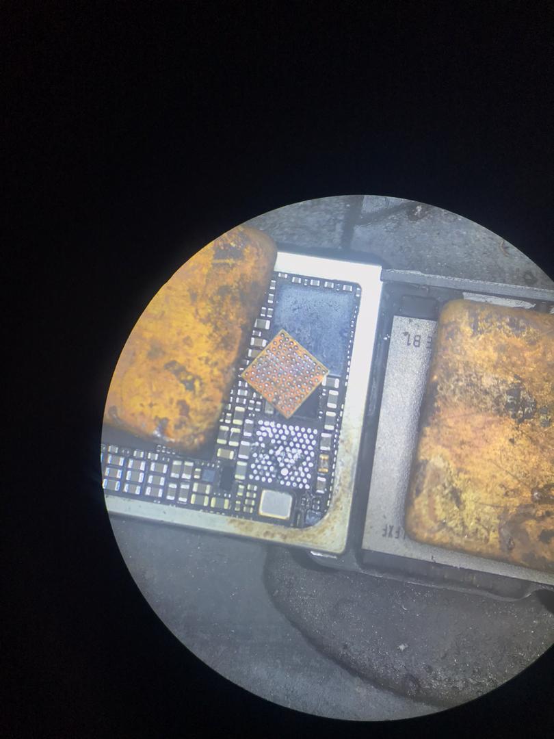

•1 The first there was no short circuit just just BBPMU_RF damaged.
•2 The second was really a work of Titan I could follow the short circuit until changed almost in damaged caps, which are:
R5601_RF
C5703_RF
C5630_RF
C5604_RF This line was really short circuit until damaged the XCVR0_RF
C5701_RF
finally the BBPMU_RF was also damaged
