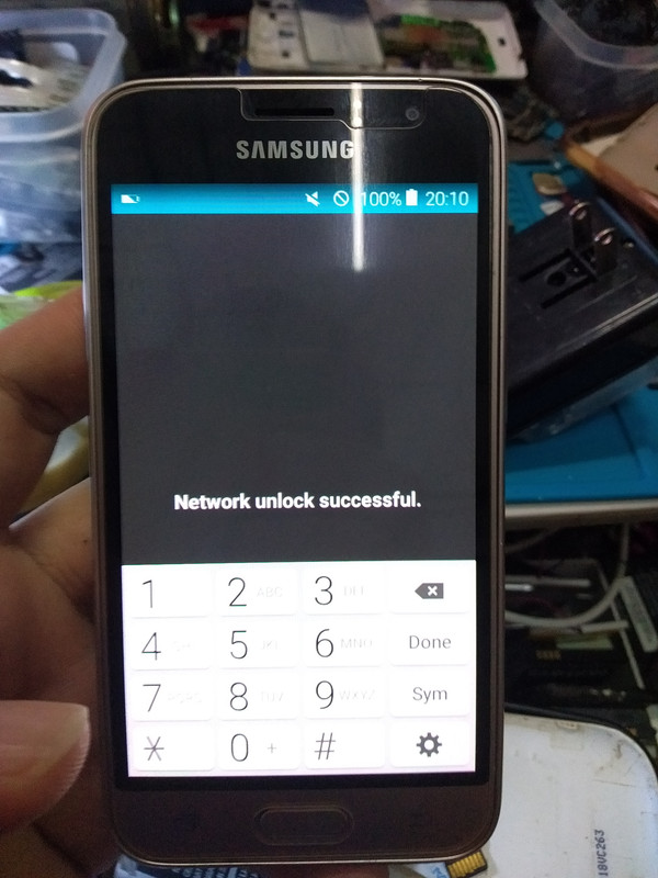

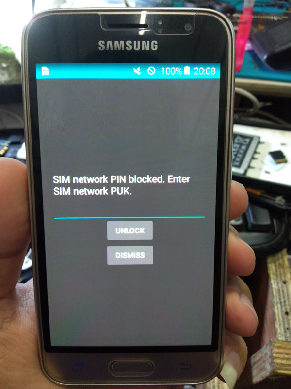

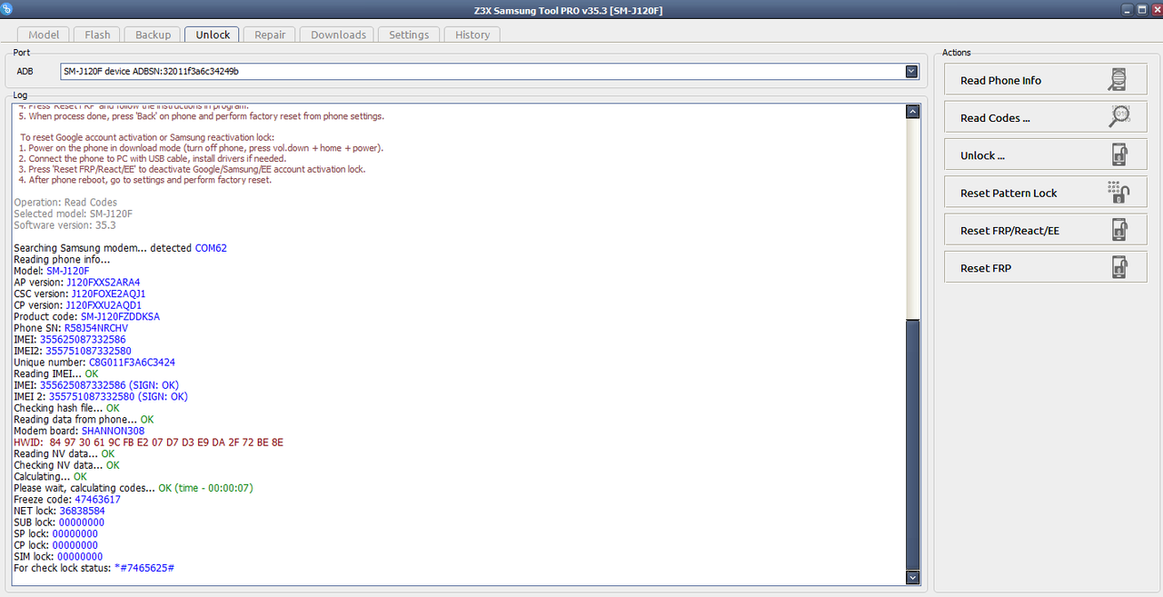

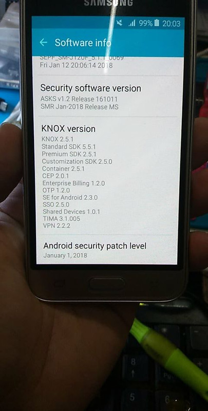

Samsung J120f (january 1 2018)patch files,UNLOCK done by Z3X..
Solution downgrade moderm firmware
i try kingo root anfd root files not done.
procedure
usb debug(developer)
Downgrade modem firmware via odin3_v3.11.1
J120FXXU2AQD1_ENG_modem_BoxWares.tar - Download - 4shared
unlock READ CODEs
Done
