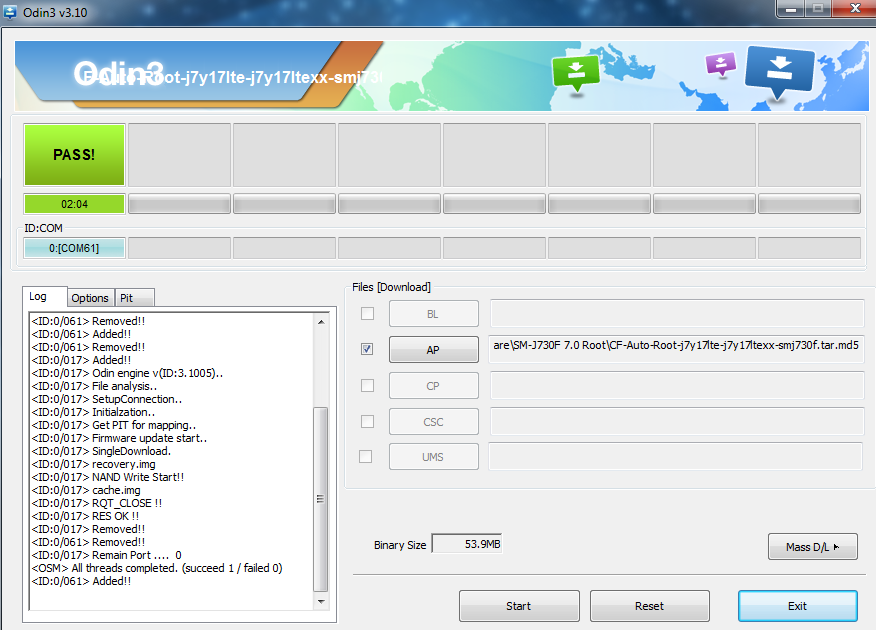

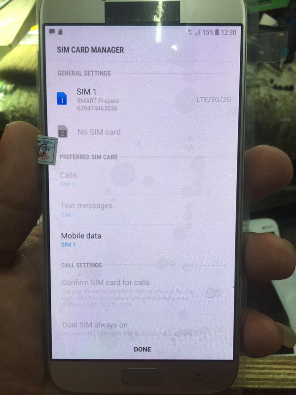

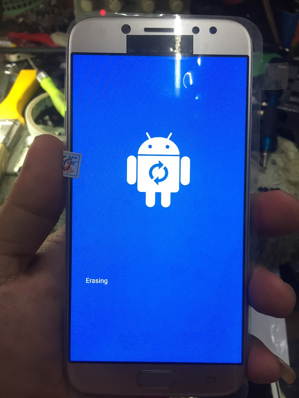

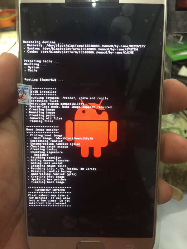

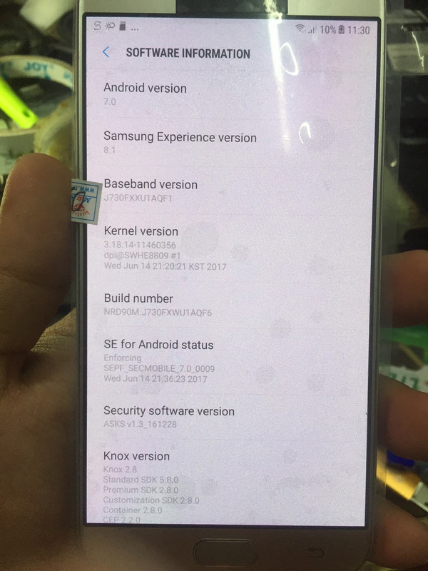

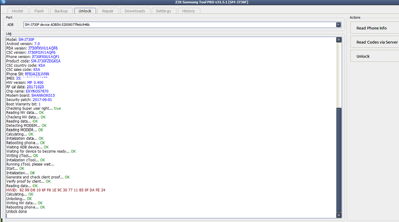

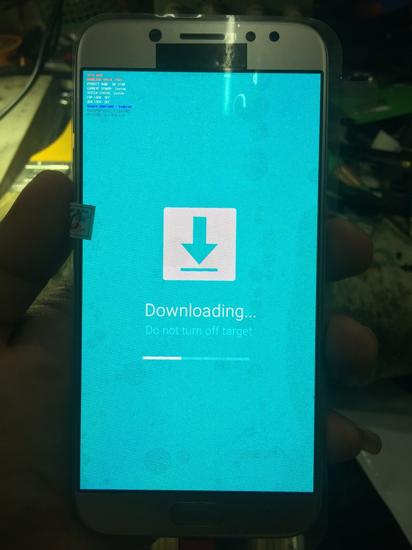

Procedure
always ON OEM and USB debugging
DL CF-Auto-Root-j7xelte-j7xeltexx-smj701f.tar.rar
ROOT via ODIN 2x root (1st Root reset 2nd Root SuperSU)

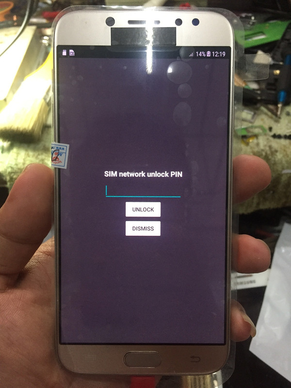

Click UNLOCK Z3x
DONE!!
uploading pictures3
imgurl
