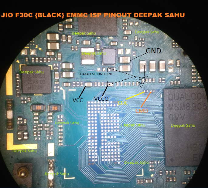

JIO F30C {BLACK} EMMC ISP PINOUT DEEPAK SAHU

Brand = LYF
Manufacturer = LYF
Model = F30C
Phone platform = msm8909
CPU Abi = armeabi-v7a
Android release = 6.0.1
Firmware version = LYF_F30C-000-09-21-021018
Firmware date = Tue Oct 2 01:39:56 IST 2018
