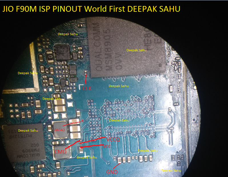

JIO F90M EMMC ISP PINOUT

Brand = LYF
Manufacturer = LYF
Model = F90M
Phone platform = msm8909
CPU Abi = armeabi-v7a
Android release = 6.0.1
Firmware version = LYF-F90M-000-03-12-110119
Firmware date = Fri Jan 11 04:31:35 HKT 2019
