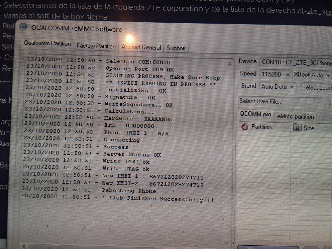

segundo JOY SMART ii
1_ DT PRO TOOL OPEN
2- We dial on the cell phone
* # 7678 #
and select "factory port"
3- We go to the windows device manager and update the "android" drivers on other devices
4- We select to choose from a list of equipment controllers, COM and LPT ports
5- We select from the list on the left ZTE corporation and from the list on the right ct-zte_3gphone_diag_interface, we install
6- Let's go to the soft box sigma
7- Platform Qualcomm
8- IMEI tab
9- We select the port ct-zte_3gphone_diag_interface
10- We place the imei to repair
11- Repair imei and voila! the computer restarts with imei ok!
