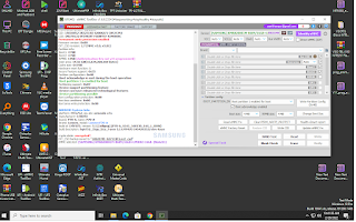

open ufi exe and identify emmc
Connection status: EHCI:HUB[#6]:USB 2.00 High-Speed
Interface: UFI High-Speed
Serial number: 0011-8840-6385
Boot version: 1.04, FW version: 1.14 (Aug 25 2021 04:56:05)
Insertion test... Done
Init bus...
VCC: 3.3 V, VCCQ: 3.0 V
Bus: 8 bit (HS SDR 52MHz)
Access mode: sector mode
Product name: R821MB (0x523832314d42), rev: 0x00, serial number: 0x8271C8F2
Manufacturing date: Jul 2015
CID: 15010052 3832314D 42008271 C8F27292
CSD: D0270132 0F5903FF F6DBFFEF 9240606C
Permanent write protection enabled
Firmware version: 0x00
EXT_CSD revision: 1.7 (MMC v5.0, v5.01)
Partition info:
Boot1: 4 MiB
Boot2: 4 MiB
RPMB: 4 MiB [Authentication Key not yet programmed]
User area: 14.56 GiB(15,634,268,160 bytes)
Cache size: 64 MiB
Hardware reset function: 1
Secure Feature support: 0x55
Partition configuration: 0x48
Boot acknowledge is sent during the boot operation
Boot partition 1 is enabled for boot
Partitioning support: 0x07
Device support partitioning feature
Device can have enhanced technological features
Device partitioning possible
Boot configuration protection: 0x00
Boot bus conditions: 0x00
Boot area write protection: 0x00
ANDROID System Info:
platform: MT6752, cpu abi: armeabi-v7a
manufacturer: LENOVO
board: P70-A, name: P70-A
brand: Lenovo, model: Lenovo P70-A
build id: LMY47D, version: 5.1 [Lollipop] (P70-A_S141_160130_16G_L_ROW)
build description: hq6752_35gu_b1a_l-user 5.1 LMY47D 1454293532 dev-keys
crypto state: encrypted?
EXT_CSD backup saved to "\R821MB_8271C8F2.ext_csd"
eMMC selected: [SAMSUNG] KMR820001M-B609/16GB+LPDDR3 16Gb (BGA221)
Read Dump File
