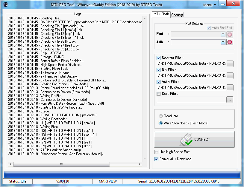

RESET BOOTLOADER SUCCESS
HUAWEI MRD-LX3
2019-10-19 10:01:45 - Loading Files...
2019-10-19 10:01:45 - Da File : C:\DTPRO\Support\Xloader Beta MRD-LX3 R3\bootloaderimage\MTK_AllInOne_DA.bin
2019-10-19 10:01:45 - Checking File 0 [preloader].. ok
2019-10-19 10:01:45 - Checking File 11 [spmfw].. ok
2019-10-19 10:01:45 - Checking File 12 [scp1].. ok
2019-10-19 10:01:45 - Checking File 13 [sspm_1].. ok
2019-10-19 10:01:45 - Checking File 26 [lk].. ok
2019-10-19 10:01:45 - Checking File 27 [tee1].. ok
2019-10-19 10:01:45 - Checking File 35 [dtbo].. ok
2019-10-19 10:01:45 - Chip : MT6761
2019-10-19 10:01:45 - Storage : EMMC
2019-10-19 10:01:45 - Format Before Flash Enabled...
2019-10-19 10:01:45 - High-Speed Port is Disabled...
2019-10-19 10:01:45 - Starting Flash Task...
2019-10-19 10:01:45 - 1 - Power off Phone..
2019-10-19 10:01:45 - 2 - Remove Install Battery..
2019-10-19 10:01:45 - 3 - Connect Usb Cable to Powered off Phone..
2019-10-19 10:01:46 - Waiting For Phone - [Brom Mode]...
2019-10-19 10:02:13 - Phone Found on : MediaTek USB Port (COM48)
2019-10-19 10:02:13 - Connected to Device [Brom-Mode]..
2019-10-19 10:02:13 - Writing Da File..
2019-10-19 10:02:15 - Connected to Device [Da-Mode]..
2019-10-19 10:02:16 - Formatting Data - Region : [0x0] - Size : [0x0]
2019-10-19 10:02:18 - Starting Flash Write Process..
2019-10-19 10:02:18 - Stage:
2019-10-19 10:02:18 - [0] WRITE TO PARTITION [ preloader ]
2019-10-19 10:02:18 - Writing Bootloader..
2019-10-19 10:02:18 - [11] WRITE TO PARTITION [ spmfw ]
2019-10-19 10:02:18 - Writing Files..
2019-10-19 10:02:18 - [12] WRITE TO PARTITION [ scp1 ]
2019-10-19 10:02:18 - [13] WRITE TO PARTITION [ sspm_1 ]
2019-10-19 10:02:18 - [26] WRITE TO PARTITION [ lk ]
2019-10-19 10:02:18 - [27] WRITE TO PARTITION [ tee1 ]
2019-10-19 10:02:18 - [35] WRITE TO PARTITION [ dtbo ]
2019-10-19 10:02:19 - All Files Written Successfully..
2019-10-19 10:02:19 - Disconnect Phone - And Power on Manually..
