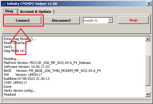

CM2SP2 helper - enable DIAG mode for SPD based devices. [Without Dongle]
Use it in case of DIAG/SVC mode failure with latest SPD devices.
1. Download CM2SP2 Diag Helper tool
HERE
2. Run exe and click to Connect
3. Connect phone to cable. DO NOT hold any buttons.
4. Wait several seconds
5. Close Tool and use CM2SP2.exe for DIAG operations
No need Dongle
No need to close other Infinity tool
