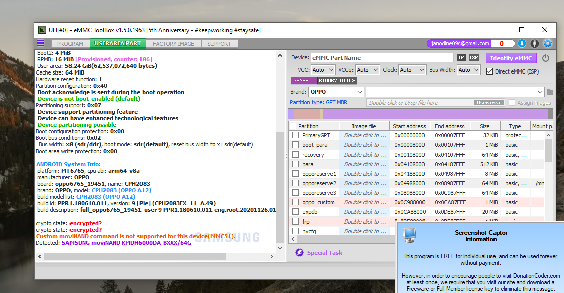

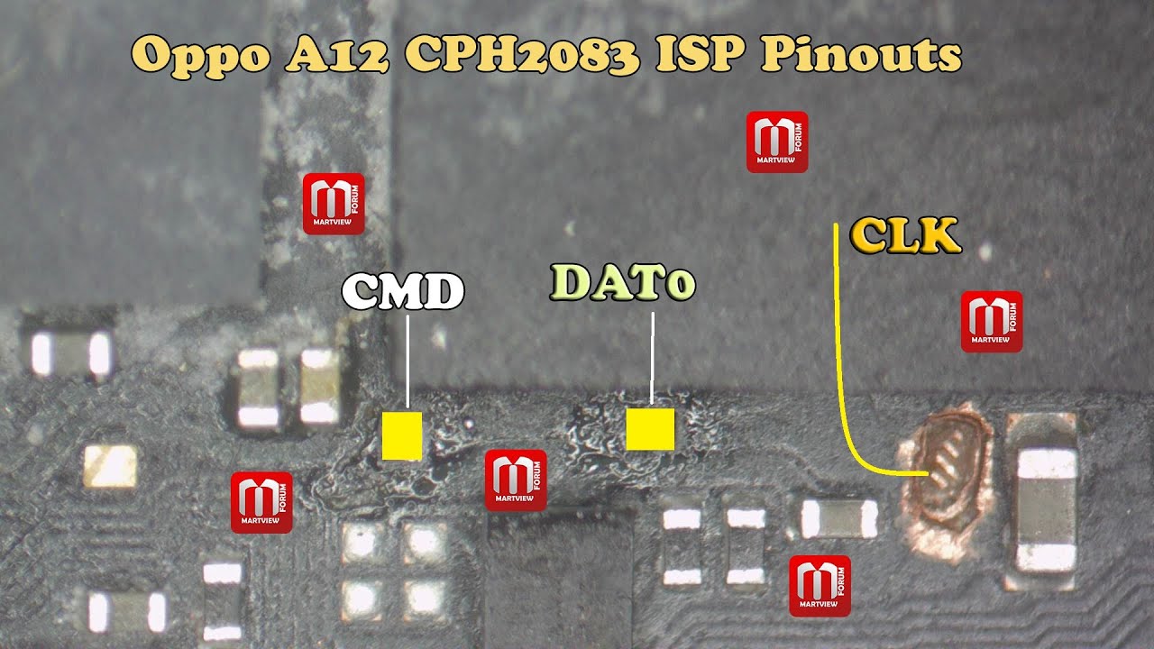

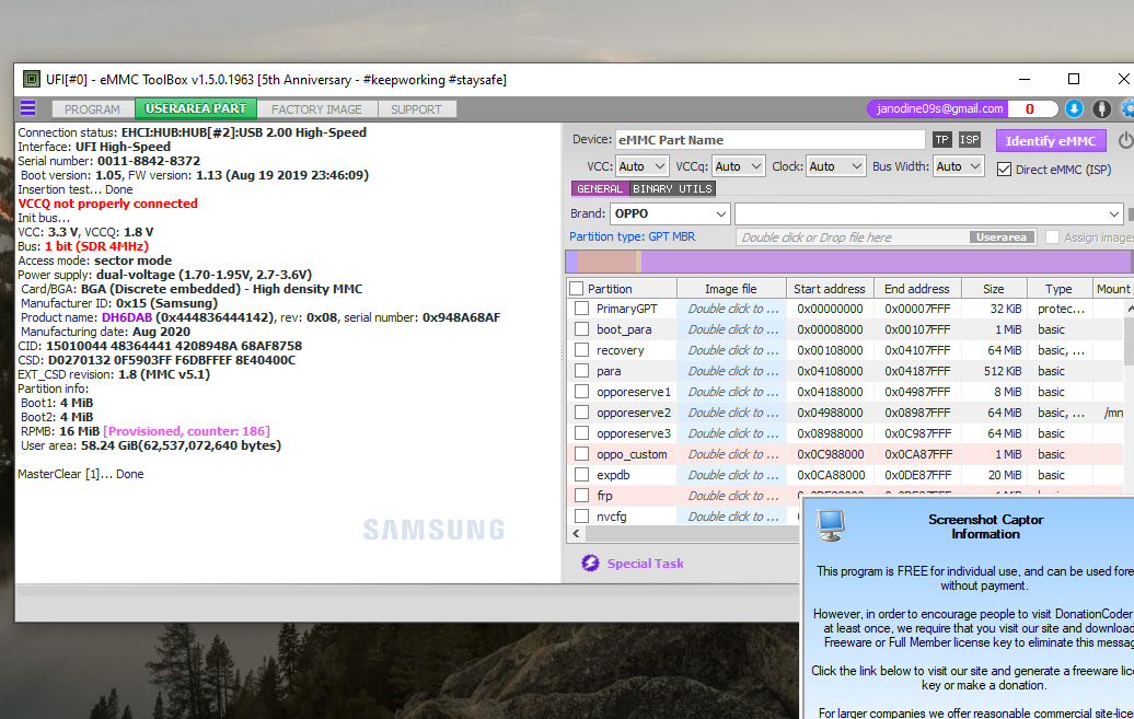

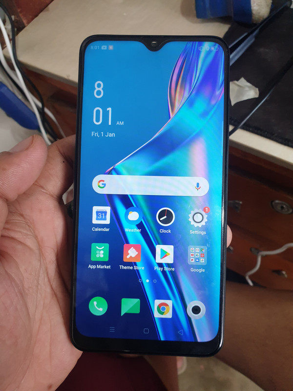

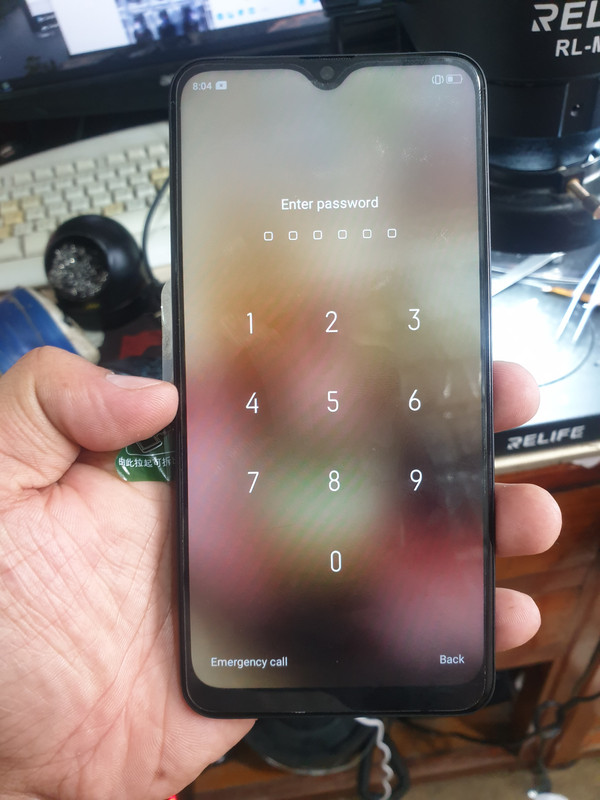

OPPO A12 CPH2083 AFTER FORMAT BY UFI DEAD
HISTORY
PASSWORD PROBLEM
Procedure
1.OPEN UFI BOX
2. TP AFTER TP
associated bank address
Follow

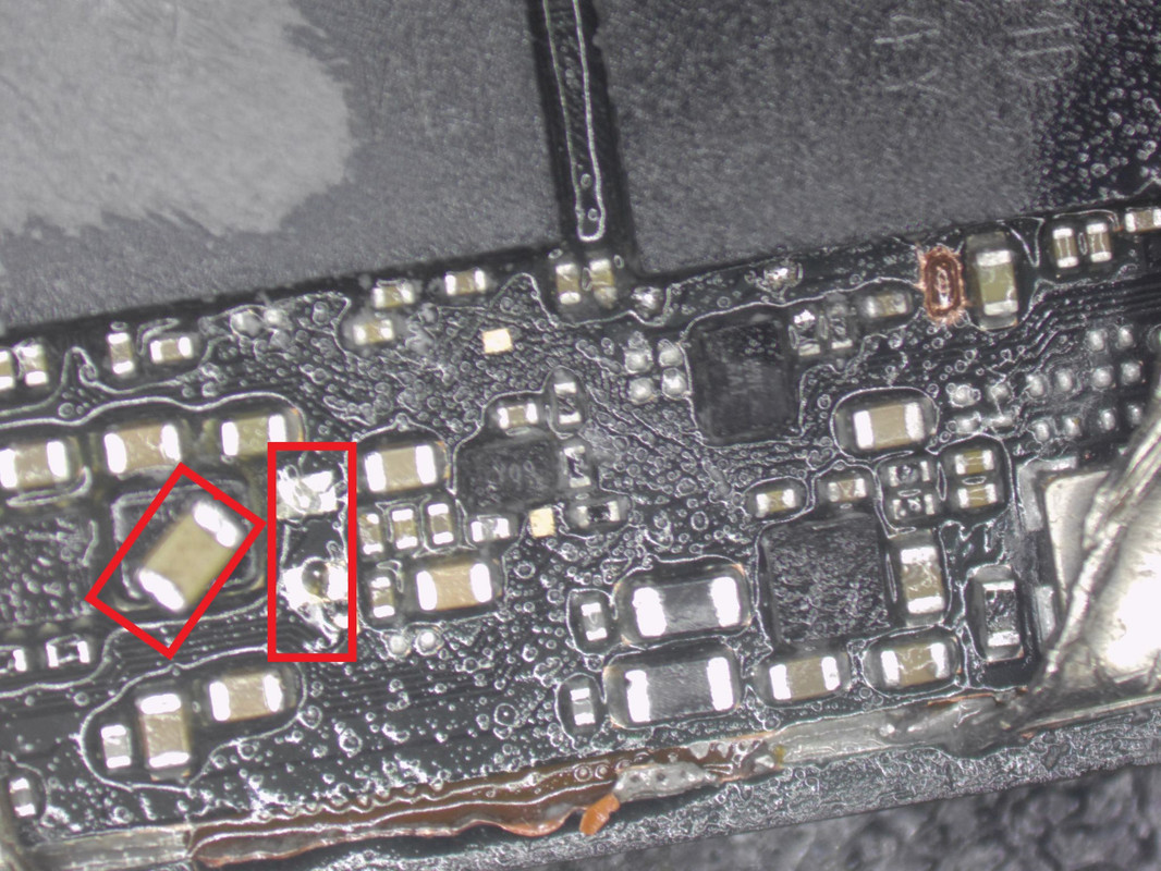

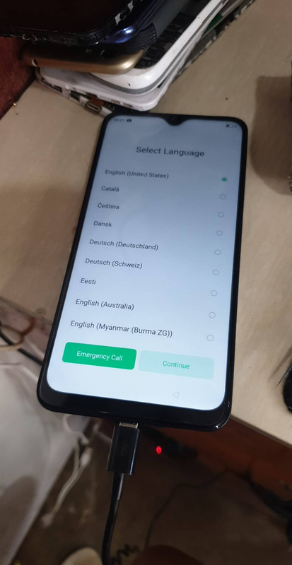

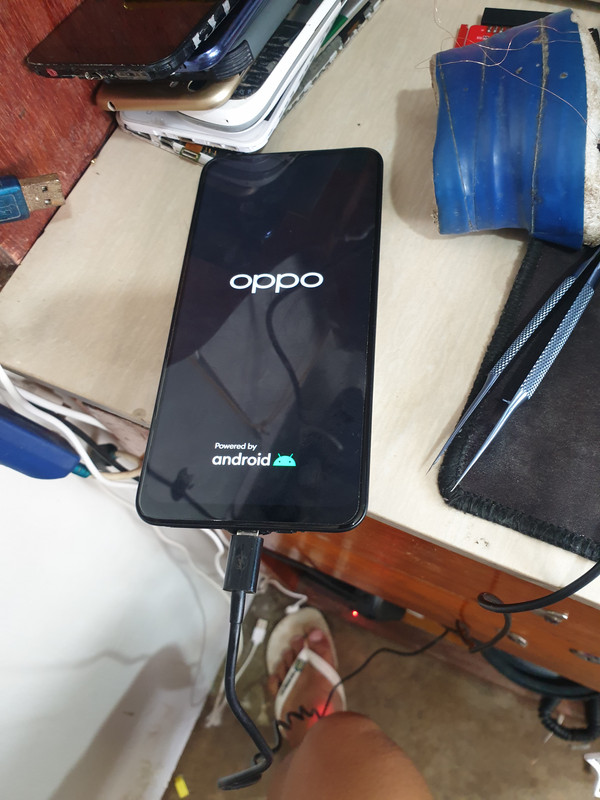

AFTER FORMAT DONE
PERO NO POWER
KAYA NAG TAKA AKO
KAYA NAISIP KO CHECK ALL
CAPS KAYA NAHANAP KO ANG PROBS
ITO REMOV DIKUNA PINALITAN REMOVE KO LANG
AFTER REMOVED
done
