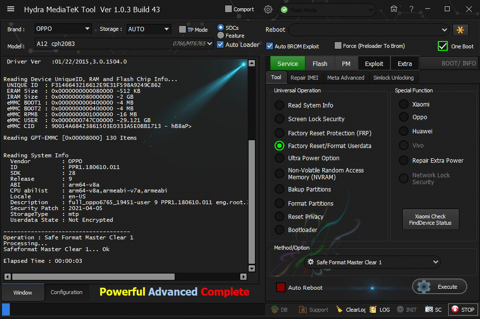

Oppo A12 (CPH2083) Factory Reset and format User Data successfully done by Hydra Tool
1. Run MTK Tool and choose "Sosc"
2. Choose Brand and Module.
3. Go to "Service"--> "Tool" from Universal Option
4. Choose "Factory Reset / Format user data"
5. Choose "Safe Format Master Clear 1" drop down menu.
6. Connect device to computer using USB Data Cable.
7. Wait until the operation is completed

FriendlyName :MediaTek USB Port_V1633 (COM7)
Device :5&10dc9a0c&0&3
SymbolicName :\??\USB#VID_0E8D&PID_0003#5&10dc9a0c&0&3#{a5dcbf10-6530-11d2-901f-00c04fb951ed}
UNIQUE ID : F3146643216612E9E31F598A9249C862
IRAM Size : 0x0000000080000000 -2 GB
eMMC CID : 90014A68423861503E0333A5E0BB1713 - hB8aP>
Reading System Info
Vendor : OPPO
SDK : 28
Release : 9
ABI : arm64-v8a
Locale : en-US
Description : full_oppo6765_19451-user 9 PPR1.180610.011 eng.root.20210403.000938 release-keys
Security Patch : 2021-04-05
StorageType : mtp
Operation : Safe Format Master Clear 1
Processing...
Safeformat Master Clear 1... Ok
Elapsed Time : 00:00:03
