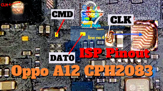

Oppo A12 CPH2083 Isp Pinout

Connection status: XHCI:HUB3:USB 2.00 High-Speed
Interface: UFI High-Speed
Serial number: 0011-8842-5573
Boot version: 1.05, FW version: 1.13 (Aug 19 2019 23:46:09)
Insertion test... Done
VCCQ not properly connected
Init bus...
VCC: 3.3 V, VCCQ: 1.8 V
Bus: 1 bit (SDR 4MHz)
Access mode: sector mode
Product name: DH6DAB (0x444836444142), rev: 0x02, serial number: 0xD706068B
Manufacturing date: Apr 2020
CID: 15010044 48364441 4202D706 068B4746
CSD: D0270132 0F5903FF F6DBFFEF 8E40400C
EXT_CSD revision: 1.8 (MMC v5.1)
Partition info:
Boot1: 4096 KiB
Boot2: 4096 KiB
RPMB: 16384 KiB
User area: 58.24 GiB(62,537,072,640 bytes)
MasterClear [1]... Done
