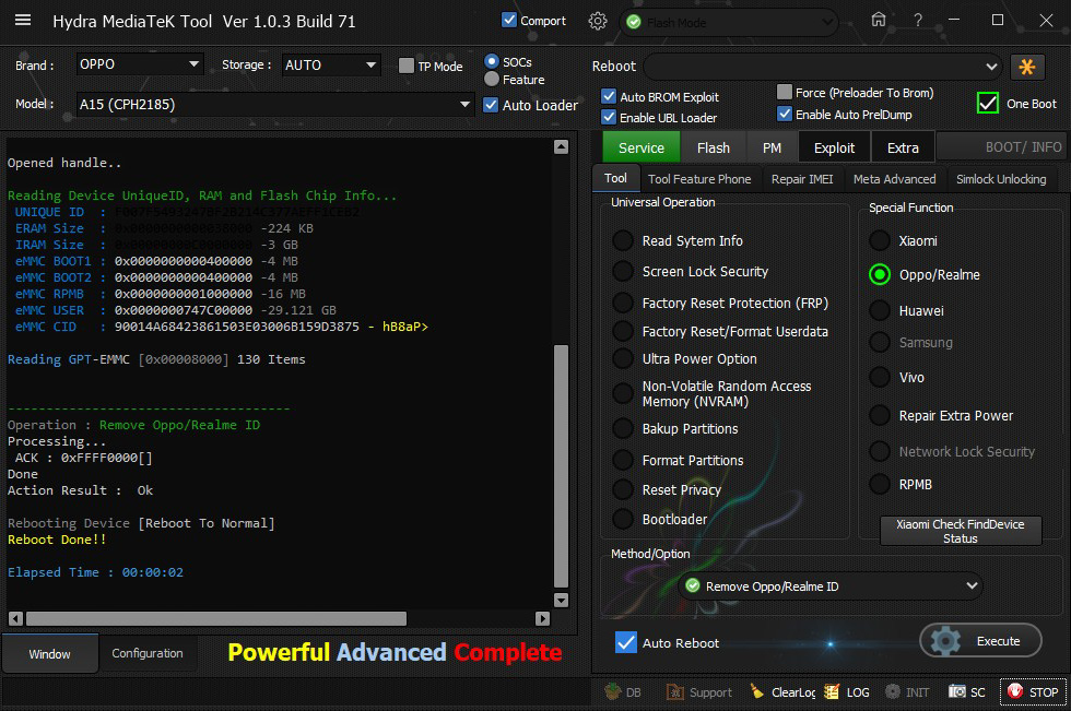

Hydra Oppo A15 (CJ{2185) removed Oppo (Realme ID) successfully done by Hydra Tool
550
Oppo A15 (CPH2185) removed Oppo (Realme) ID successfully done by Hydra Tool
1. Run Hydra MTK module.
2. Choose Brand and Module
3. Tick "ComPort"
4. Tick "Auto Broom Exploit", "Enable UBL Loader" and "Enable Auto PrelDUMP"
5. Go to "Service" -->"Tool" Tab.
6. Choose "Oppo / Realme"
7. Choose "Remove Oppo/Realme ID"
8. Tick "Auto Reboot"
9. Click "Execute"
10. connect device to the computer with USB Data cable
11. Wait until the process is completed.
