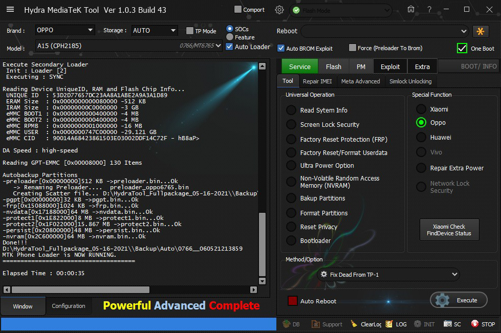

Oppo A15 (CPH 2185) fix from Dead from TP done by Hydra Tool
1. Run MTK tool.
2. Choose Correct Module and Brand.
3. Go to "Service" -- > Tool"
4. Choose "Oppo" tool from universal option.
5. choose "Fix dead from TP-1" from "Method / Option" drop down menu
6. Click on "Execute" and connect device with computer using USB cable.
7. Wait until the process is completed.
Brand : OPPO Model : A15 (CPH2185) Connection : Flash Mode
How To Boot : Power off phone
* BROM Mode : Press VOL + or Press VOL -+
FriendlyName :MediaTek USB Port_V1633 (COM18)
Device :6&27c7ce02&0&5
SymbolicName :\??\USB#VID_0E8D&PID_0003#6&27c7ce02&0&5#{a5dcbf10-6530-11d2-901f-00c04fb951ed}
Handshaking...Ok
Identifying Hardware ID.....
Reading Device hardware info..
hw code : 0766MT6765 [6765]
hw subcode : 8A00
hw version : CA00
sw version : 0000
Target config : E5
SB : 01 (True)
SLA : 00 (False)
DAA : 04 (True)
Exploiting Device...
Exploit Sent..
Successfully Exploited...
Handshaking...Ok
hw subcode : 8A00
hw version : CA00
sw version : 0000
Target config : 00
SB : 00 (False)
SLA : 00 (False)
DAA : 00 (False)
FUSEID : 00000000
SECURE VERSION : 00
BL VERSION : FE
NORMAL BOOT
Preparing Download Agent..
DA : [Not Exist]
Trying Default 6765.bin
Ver : MTK_AllInOne_DA_v3.3001.2020/03/17.上午10:04_497508
Init : Loader [1]
Sending : Accepted
Identifying Protocol...
Protocol : New
Synchronization...SYNC
Mode : brom
Preloader Initialization...
Parsing A15s_preloader_oppo6765.bin
Init : Accepted
Execute Secondary Loader
Init : Loader [2]
Executing : SYNC
UNIQUE ID : 53D2D77657DC23AA8A1ABE2A9A3A1D89
eMMC CID : 90014A68423861503E03002DDF14C72F - hB8aP>
DA Speed : high-speed
Autobackup Partitions
-> Renaming Preloader.... preloader_oppo6765.bin
Creating Scatter file... D:\HydraTool_Fullpackage_05-16-2021\\Backup\Auto\0766__060521213859\MT6765_Android_scatter.txt
-frp[0x15088000]1024 KB ->frp.bin...Ok
-nvdata[0x17188000]64 MB ->nvdata.bin...Ok
-protect1[0x1E822000]8 MB ->protect1.bin...Ok
-protect2[0x1F022000]15.867 MB ->protect2.bin...Ok
-persist[0x20800000]48 MB ->persist.bin...Ok
-nvram[0x2C600000]64 MB ->nvram.bin...Ok
Done!!!
Elapsed Time : 00:00:35
