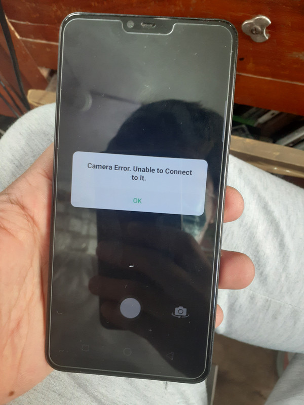

camera error unable to connect to it

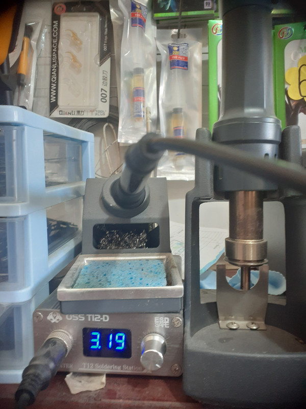

Needed:
1. OSS T12 D
SOLDERING

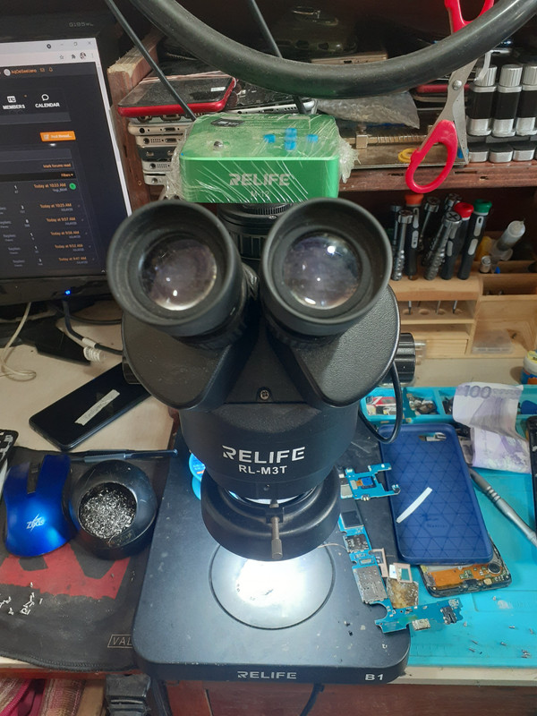

2. RELAFE RL M3T
MECROSCOPE

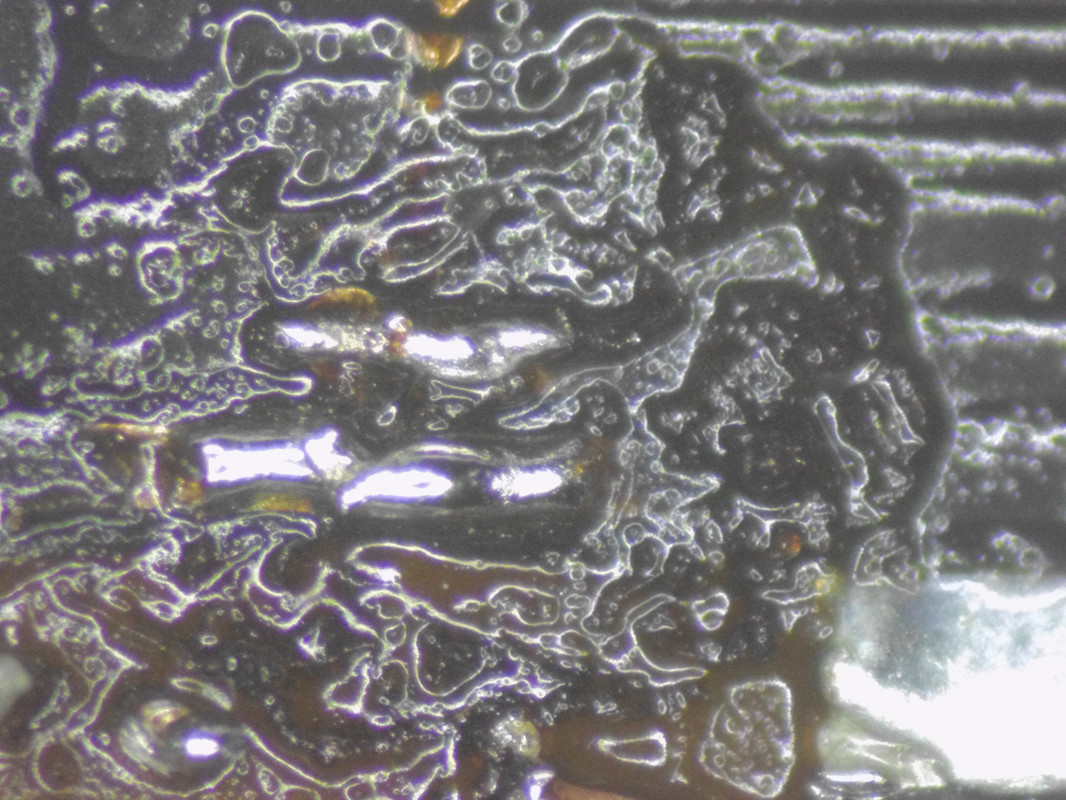

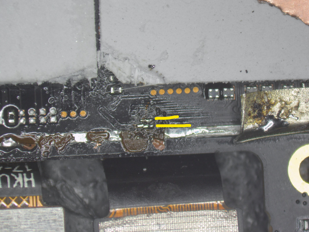

3.KAYA NAISIP KUNG
CHICK UNG LINE MAY NAPANSIN AKUNG
PUTOL YAN NASA PICTURES
4. KAYA NAISIPAN KUNG JUMPER
PERO ANG GINAMIT KUNG PANG JUMPER
EH LED LANG KASI DI GAANO KALAU UNG
PUTOL 5 LINE UNG PUTOL
PERO DALAWANG LINE LANG UNG
JUMPER KO

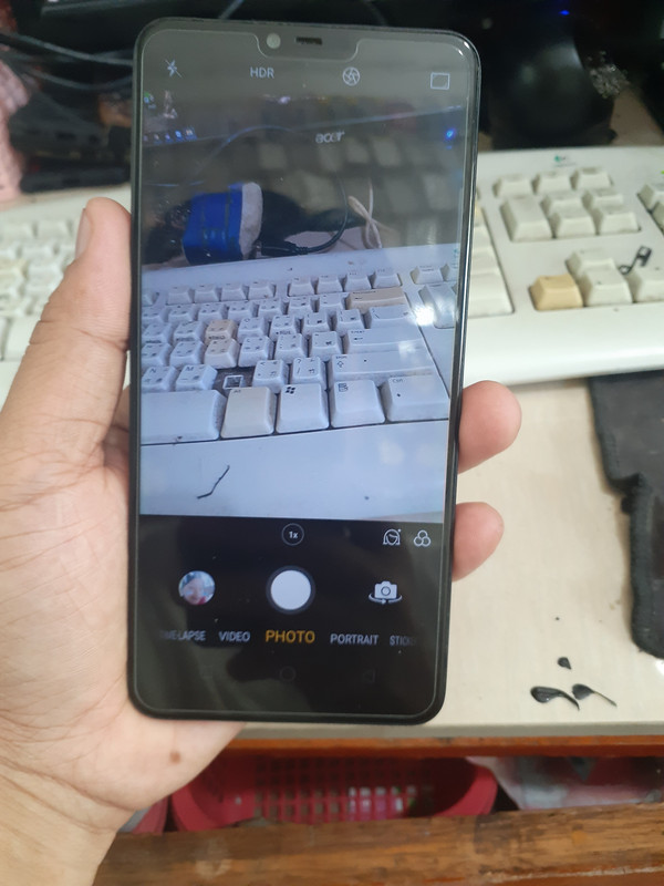

5. AFTER JUMPER DONE
THANKSS
