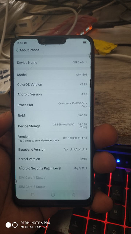

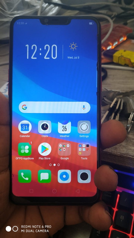

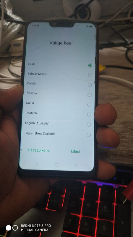

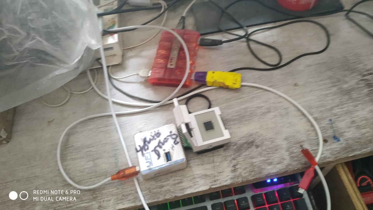

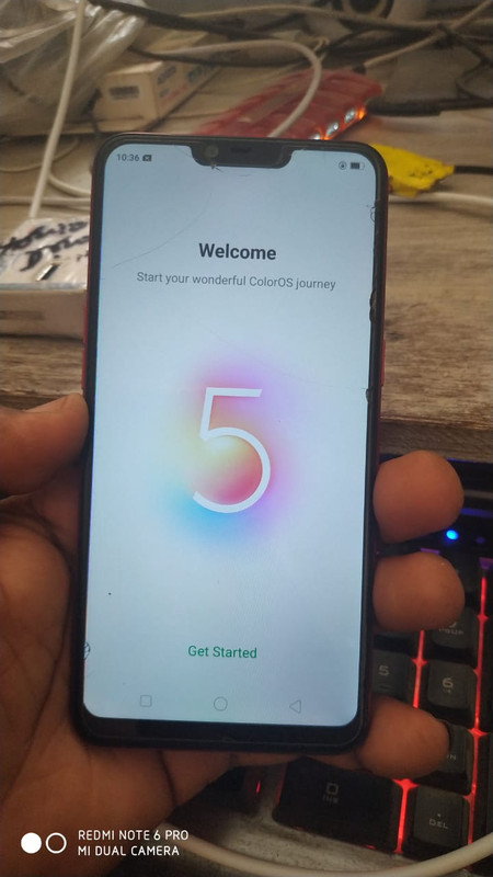

OPPO A3S Dead By Other Jtag Box By Other Technician Remove Emmc , Repair Emmc / Reprogram With Ufi-Box
All Job Sucessfully Done By
Ufi-BOx
Dr.ResearchCenter Team
HITECH CARE
Nov 5, 2018
28
86

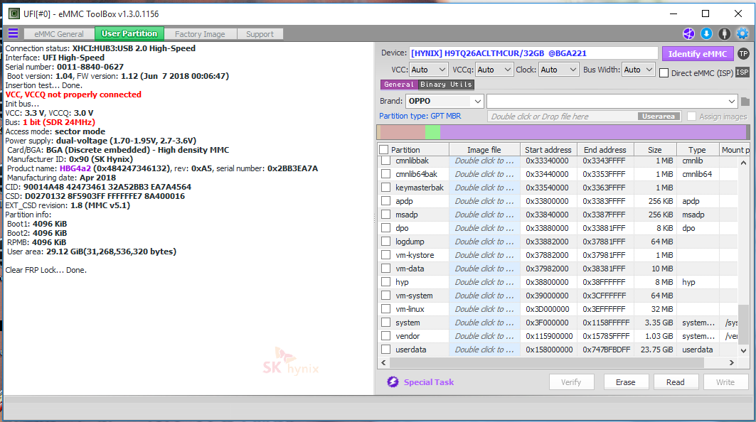

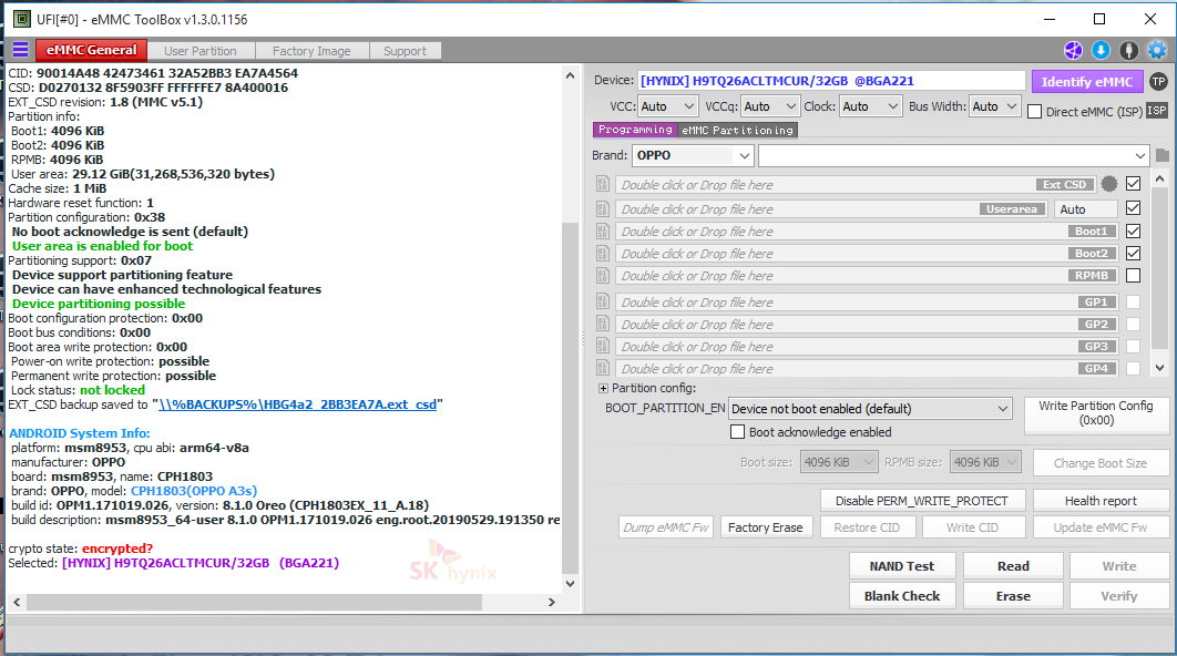

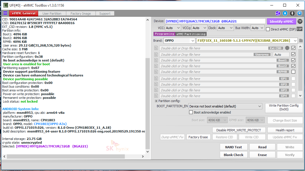

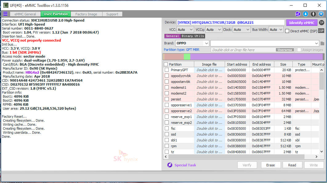

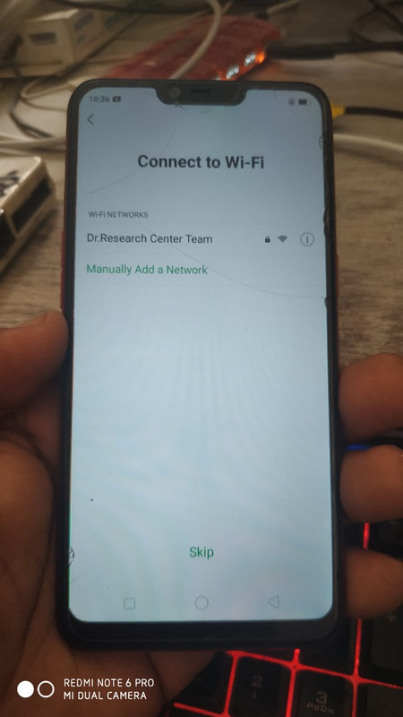

Its A Fake Post ...How Lets Check Some Facts
#1 Post 1 Show Identification Log Which Shows Android Info With Complete Details Means Handset Is On...
#2 I Don't Foun'd Any Spsl Task Done To Retive This Handset Only Write Dump (No Need To Write As Its Already Ok)...
#3 Its Show After Dump Write All Ok N Working How's Its Possible What About Security Part As I Know If U Write Dump Security Needs To Be Repair How He Manage To Do It..
4# What A Coincedence He Having Dump Same As Phone Build Info (Same Build Same Ver Same Compile Date)...
He Just Read N Write Dump On Alive Handset N DO Factory Rest Just To Make Users Fool....As Per I Know If I Am Wrong Kindly Correct Me
